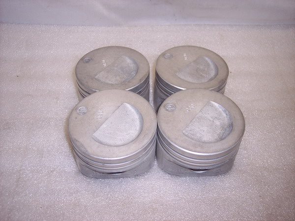

Here are some pictures for the "destroking question." I think what people are referring to as "destroking" means bleeding off compression. Which piston bleeds off more compression? I'm guess the d shaped recessed head bleeds off less than the other. Am I correct in this?

De stroking is in reference to the ch compression height on a piston. The ch of a given piston is the distance from the center of the piston pin hole to the top of the piston. On a domed or contoured piston the top from which the measurement is taken some times a reference point and not the true top.
When a piston is "de stroked" the ch is reduced so that after re machining the block and head the compression will remain basically stock.. A common amount to de stroke is .020-.030".
With an engine that originally was manufactured with the thin steel head gaskets(.020 thick) and a modern head gasket (.040 thick) is used to rebuild the engine a destroked piston will significantly lower the compression ratio. Not what you want.
I truly feel that with todays fuel an IH can have its compression ratio raised .5-1 and suffer no problems and easily use low test regular.
Silv-o lite pistons would be a great piston and they are not destroked.
As for you pictures the piston style is not a issue in de stroking only that you reinstall the same/correct style. The first picture is a non emmissions "contoured) style and the second is an emmissions 392/196 pistone. He notch comprissing 10cc is used to make the compression ration what the IH engineers desired.
The piston dome profile must match the head you are going to use. The domed piston is the "pre-emissions" design, the flat top with eyebrow is the emissions motor.
Silvolite pistons in both cast and hyper-eutectic are readily available in the "flat top" design for this application in any oversize. However, any piston of the proper dome design is more than adequate for any "built" 152/196 motor.
You must look at these engines as a "system", selecting the wrong piston design for the head profile will result in valve collisions. Simply mixing and matching parts in an indiscriminate manner will only lead to an uncompleted motor once the money pit runs empty. This one got real close to becoming a "project" instead of a viable dd motor, take a badly trashed 152, swap in a badly trashed 196 that had mucho casho dumped into a non-oiler from the git-go, then try and marry an early 196 with a late 196 that had been cleaned but also had the block and crank trashed, and whadda ya git??:
