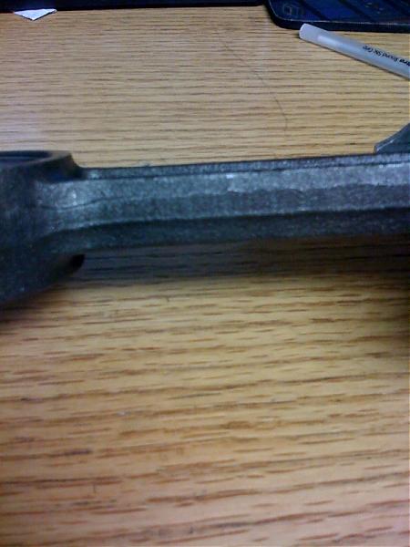

A forged part is much stronger that a part machined out of a billet blank that is not forged. Forging creates the grain structure of the steel to be uniform and lay in a common direction so load is shared equaly. The pitman arm should be forged only and not cast.
But for referance the parting line where the die halfs come together create a large margin (1/8-3/16) on a forging that is usualy ground down, a casting has a fine line there that is maybe less than 1/16".
I attached a photo of a typical forging parting line. In this instance it is on a connecting rod. A similer line should be seen on a forged pitman arm.
