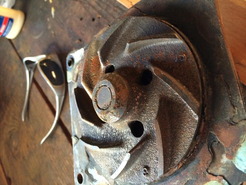

Well, I yanked the water pump. It looks perfect. It's got the better cast iron impeller, too. I looked very closely at it and it also looks like there is no way that the impeller has ever rotated separately from the shaft. Their is plenty of gunk in the seam to suggest that.
So. I guess I put everything back together and get a combustion tester. If it shows positive, can anyone recommend a method to determine which head gasket is leaking? Also, is there any sense in just taking off the valve covers and trying to retorque the head? Or once the gasket goes, it's gone?

Wow that's cool you have the cast iron impeller.

wow that's cool you have the cast iron impeller.

Agreed! I May keep it and take it to a local rebuilder. Those are hard to find anymore. It's in great shape too.
