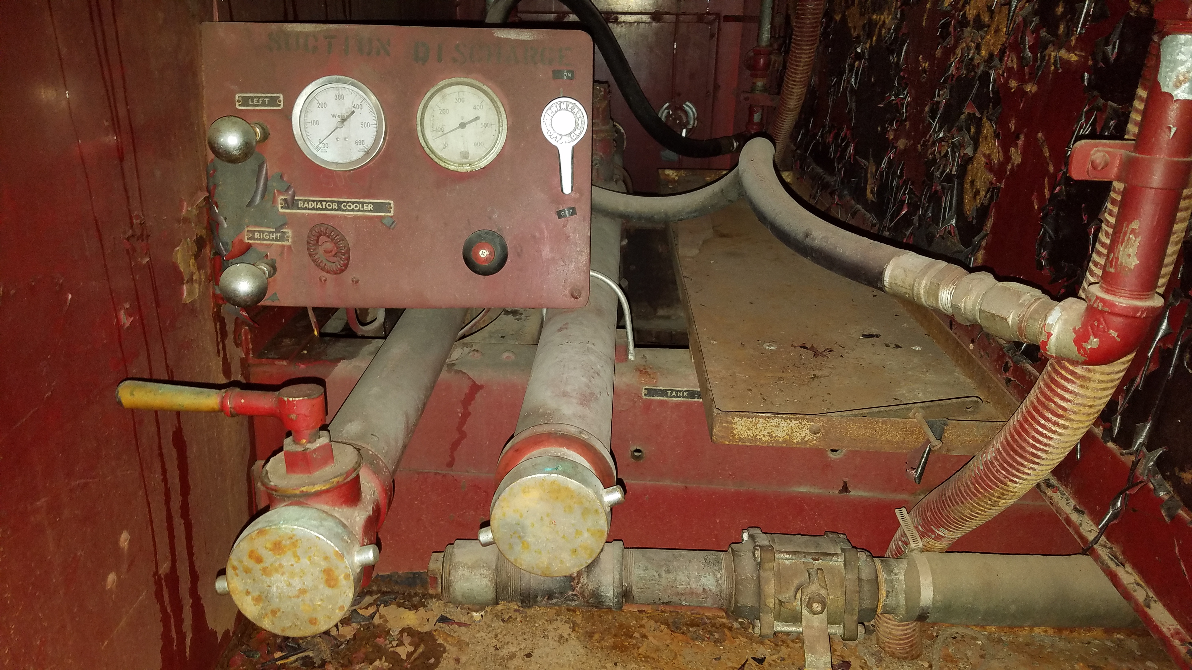

Engineer Reed here, lets see a pic of the pump panel. PTO or Auxiliary pump? Not a lot of medium duty truck fans here. Congratulations!

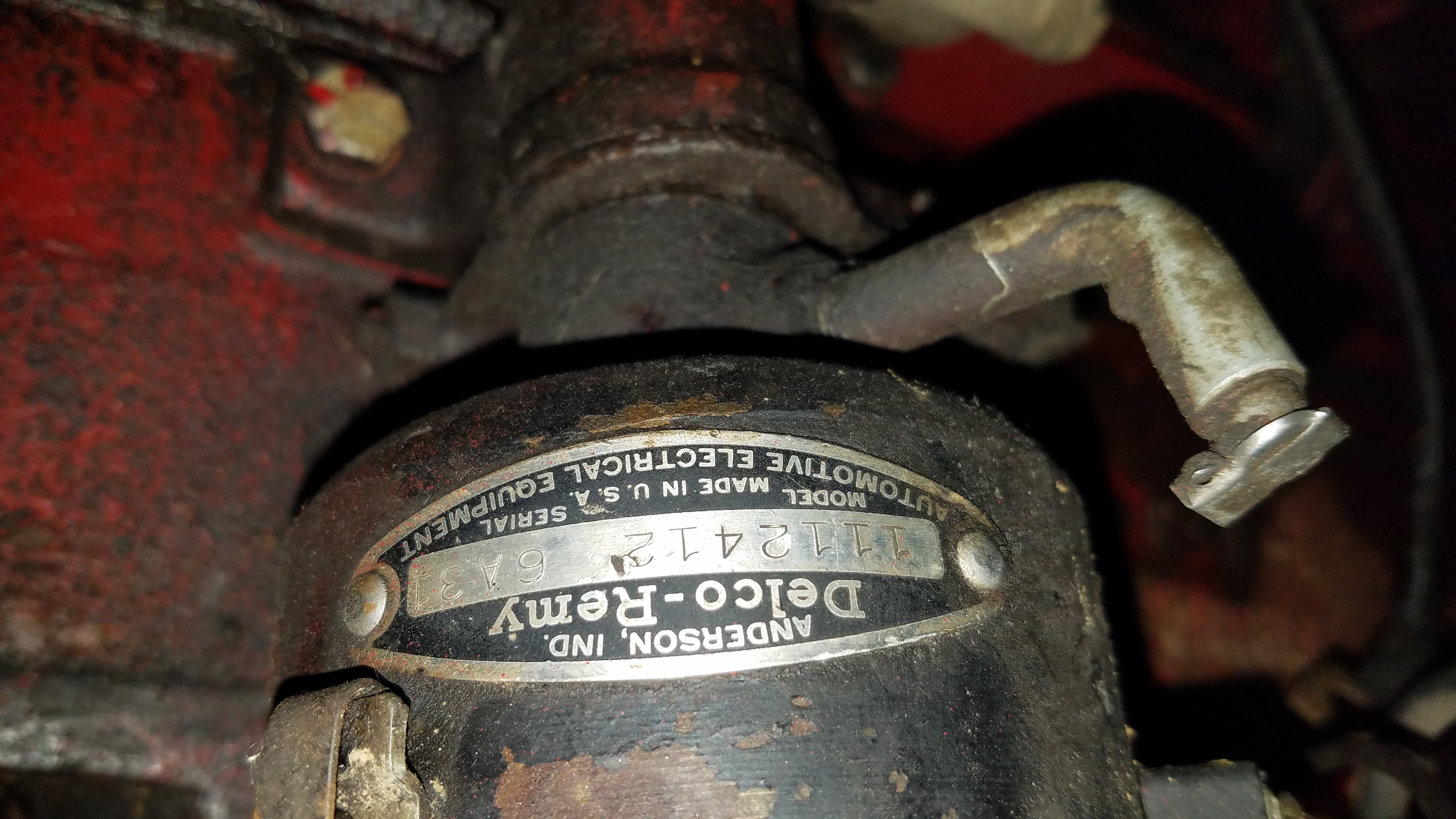

Please verify that your engine has a Delco distributor.
Also provide the Delco part number of the distributor. It should be on the distributor body on a plate or tag.
It should be a seven digit number.

Here's a picture of the panel. It runs off the PTO and has a power control in the cab. To be honest, I'm still trying to work out how it all operates.

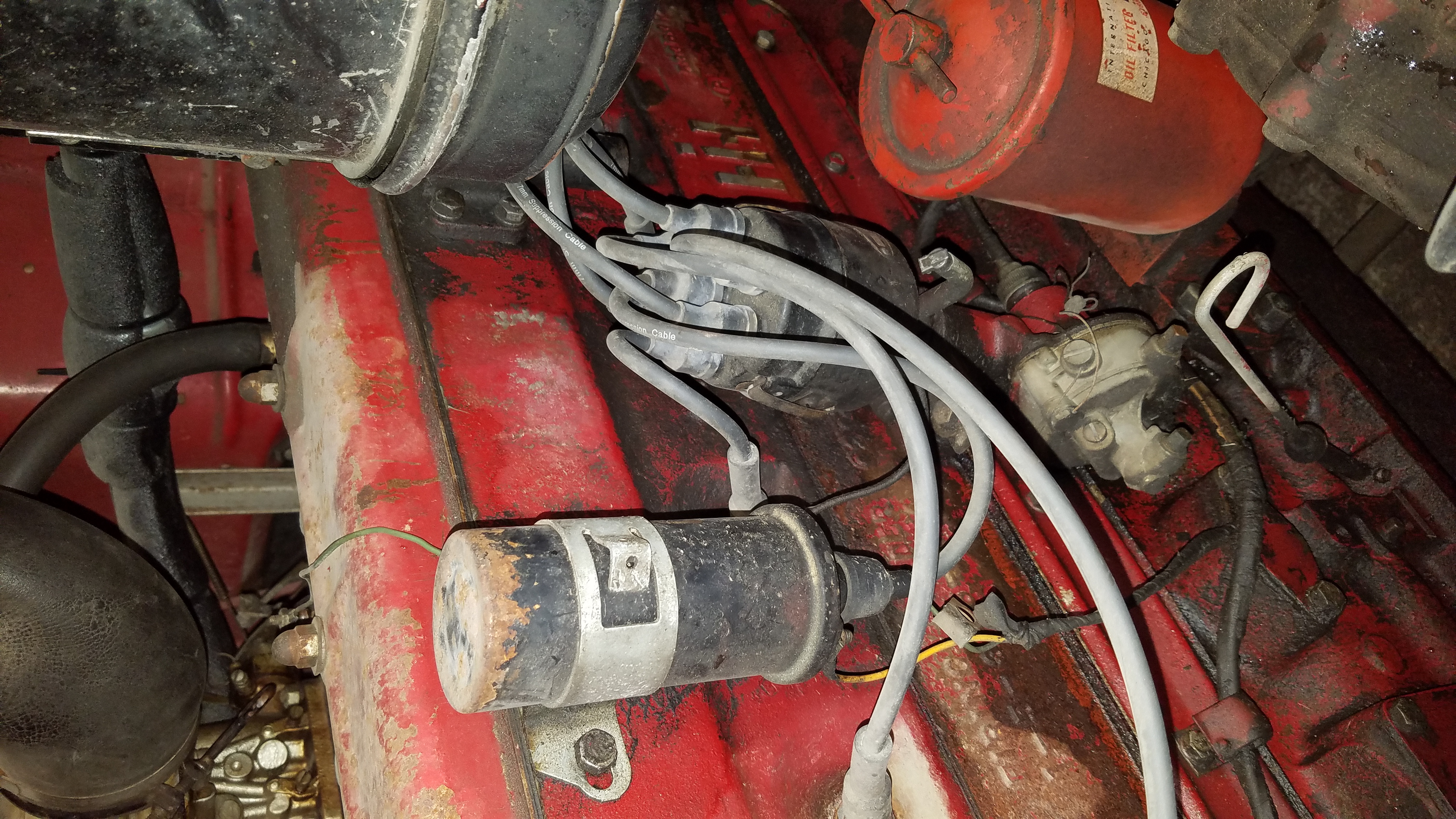

I wasn't able to get the distributor cap off this afternoon but I did get photos of the ignition system (see attached). I'll try tomorrow...we have a big storm starting tomorrow so it doesn't appear that I'll be going anywhere for awhile...
That's a nice simple panel and you won't get distracted be a lot of blinking lights. There are 2 types of PTO one has the transmission in gear and the other in neutral. What are you trying to workout?
Honestly, right now I'm working on driveability (carb kit, ignition work, etc) and then I'll try to do something about the gearing. Also need to add turn signals (surprised to learn they weren't standard) and a few other items. Then we'll worry about the pump and its operation.
