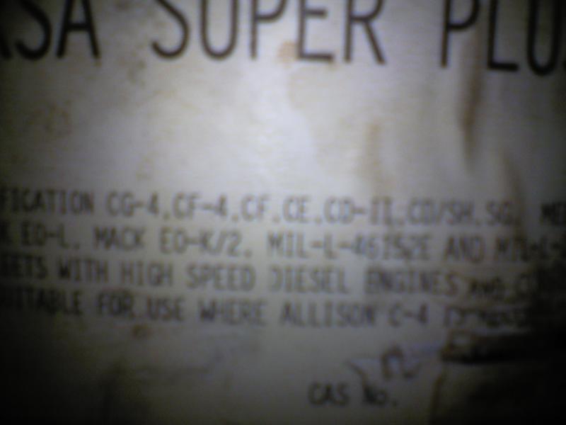

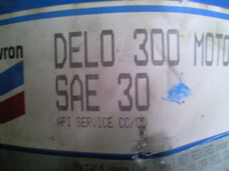

Sorry about the confusion on the name, too many in this old ass head. Anyway I took pics of the specs on the ursa and there are none listed on the delo except the api rating which is cc/cd. The pic on the ursa is kinda hard to make out but its readable.

It appears that the delo 300 in the picture is rated as a diesel
only oil as there are no specs for gasoline (which would be prefaced by the letter "s".
"c" is a diesel oil which stands for compression
"s" is a gasoline rating which stands for spark
the ursa has a pretty old gasoline rating, and honestly, even tho you got a "good deal" I would not use anything older than an oil rated "sj." the sj was the precursor of sl which was the last oil rating before sm (which has the lowered additives for use in 2007 and newer gasoline engines)
if you have access to someone who utilizes used oil analysis, it would probably be cheaper to go through them than to go direct with a big company like polaris (horizon) who requires you to purchase 10 sample kits at one time. But, as I mentioned before, whatever you do is strictly your choice as I personally would not go back that far using oil technology that old.
