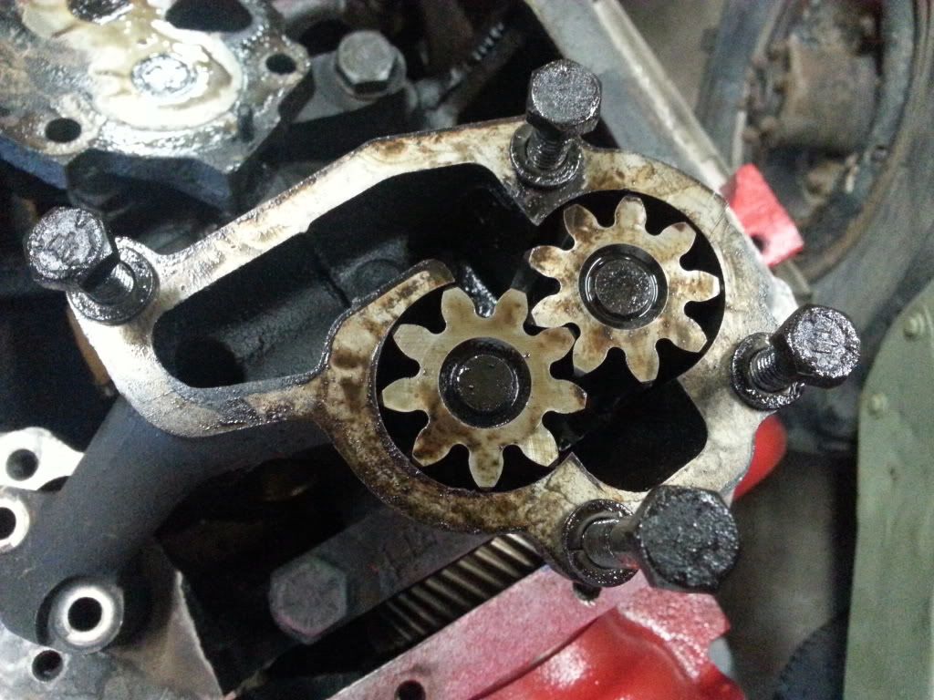

Rebuild kit is in the mail! Quick question. How do I get the gear with the shaft to the distributor out? The shaft is wider at the top and cannot just pull through. Just cut it?
I picture is worth a thousand words....
When rebuilding, do I just cut the old shaft in order to get the old gears out? The new shaft does not have this little extension.
That little extension is a thick wall tubing piece that has a crimp in it to retain it to the shaft. You press it off the shaft if you have a press, or put it in a vise and drive out the shaft. Instructions in the service manual show pics of how this all goes together.
I never destroy old parts, especially increasingly rare oil pump parts - unless they are already destroyed or must be destroyed. In my recent rebuild I did just what you are now doing. I pressed off that sleeve and in the end re-used the old gears - still serviceable - because I got minor clicking with the new gears and saved those for a later time when I had the patience to deal with filing off the nicks, burrs or whatever.
