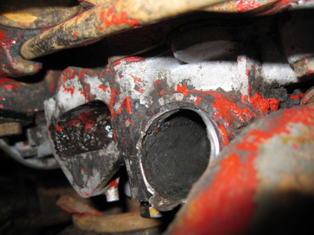

Here are some pics I took of the oil filler tube and the engine block. Any suggestions?

That one is not good! Looks to be broken off flush so there is nothing to "grip" outside of the hole.
And obviously it's still on the motor, still in the truck, I can see the water tube above.
That one will be a bitch to remove even if the timing cover is on the bench. It would be well worth your time to pull it, ya need to service the front crank seal anyway.
If you don't pull the cover, then I'd remove the radiator and fan assembly for access. Then remove the water tube. Prolly need to pop the alternator off also to provide some additional room to maneuver.
Then I'd use an angle-head die grinder with a thin cutoff wheel and grind through the remains of the tube wall on the inside, being careful to not cut into the aluminum bore. Or an alternate would be a pneumatic hacksaw with a cut-down blade.
You May have to cut through the tube wall at two points. Idea is to remove the pressure of the "press" fit and also the fact that due to electrolysis, the two parts have grown together.
Once the tube wall is cut through, then soak the area in a penetrant...I like "kroil" for locations like this but anything will work such as pb blaster, etc.
Take a very thin chisel and carefully try and collapse the remains of the tube inward. Once it's collapsed slightly, then ya can pull it out with small vise grips. May need to help it with a careful application of heat from a heat gun.
You have to be very careful banging on that boss where the tube is inserted or it will crack/break.

Actually there is a decent tab of the oild filler tube that you might not have been able to see in that original pic. I posted it again, but no so small this time. Since there is some of the old filler tube, whats the best way to pull it outta there?
Perzactly as Mike has described for ya.
It was an interference fit, and has grown together. That tab that's remaining won't be enough to yank it out without breaking it off. You might get lucky, but the cards don't look in your favor for that play. If you go to cutting on it with it on the block, put something in the hole to catch the shavings. If you get it out without damaging the cover, I like the idea of bung'in it and going to a different valve cover.

I removed two filler tubes tonite from really rotten timing covers, your post got me motivated to do that nasty work! But at least mine have the tubes intact!
Keep in mind, both covers were off the engine and clamped securely in a vise with jaw protection. I heated both of them around the tube area witha propane torch, the heat gun would not expand the aluminum enough.
Using the tube for a lever, I was able to break 'em loose with mucho heat, once they rotated, then they came right out.
So...what ya might try is setting up some big visegrips on that remaining tab. Then apply significant heat and see if ya can break the stub loose. But please clean all around that area really well...we don't wanna hear about an underhood fire in another thread dude!!

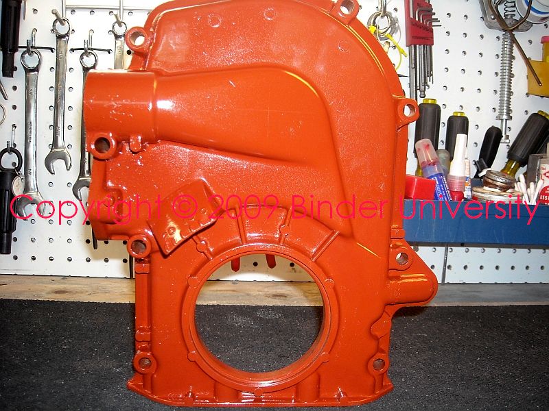

If ya end up inna bind and can't get the stub out, ya can send the cover to us for a re-work. We'll remove the stub, clean the cover so it looks like the one in the pic, and install the oil filler tube of your choice, and knock in a replacement seal. If your crank hub is "grooved", then send it along and we'll repair the seal surface with a sleeve. Cost for the total package would be $155 pus return shipping to yore door, and will include a replacement timing cover gasket and water tube "o" rings. The entire assembly will look better than new when ya get it back and ready to plug and play.
