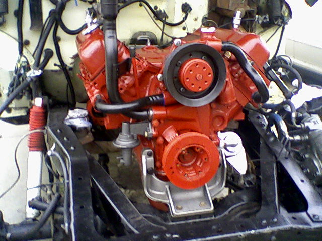

Front oil fill tube goes into the timing gear cover. You will need the cover and the tube from an early sv.
Makes it nice and easy to add oil and keeps the dirt out of the valve train.
