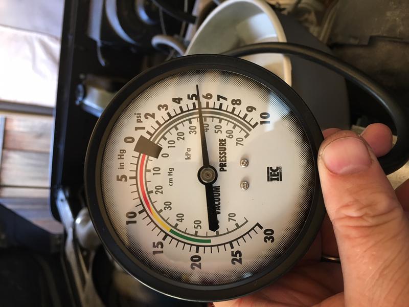

-Plumbed in with "T" fitting just before carb and am getting steady 5.5 PSI (Pic Attached). Is this low, high or standard, will do some thread searching to see if I can answer.

good pressure. FP it making the necessary pressure to fill your carb fine. We can ignore that for now.
I If you do not have a filter on the carburetor side of the fuel pump you are probably good with the pump you have. When you stop the engine, the gauge should hold the pressure a while.

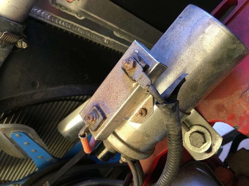

Anybody know what this little thing is? I have mounted on top of the coil. Following Roberts train of thought regarding coil, wondering if this could have something to do with something? Not sure if this is standard or PO syndrome?
