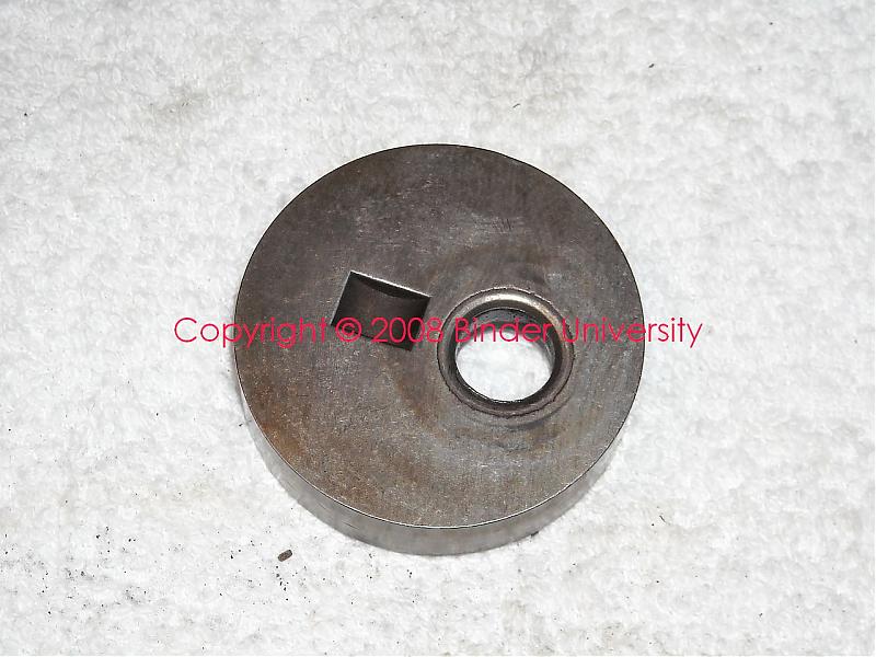

Robert and I jawwed about this "key" deal today.
Here's a shot of the rear of the fuel pump eccentric with the "relief" that the tail of the woodruff key engages.
Verify that ya have the eccentric correctly installed.
