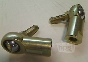

I have an auto in my Scout with a NP205. But I had to make some custom shifter linkage. I just used the stock shifter with some 3/8 all thread and some rod ends to connect the shifter to the t-case.
rod ends
The pivot point for the shifter will take some thinking and some test fitting. Your setup is different from mine as I have a 4x4 727 vs a 4x2 version used with a divorced t-case. You could build off the current crossmember or even add a second one if needed. I used a piece of 1x2x.120 about 8" long to come off the crossmember mount as I needed to keep shift linkage level.
You will have to just put some stuff together and see how it moves. I'm having to add some supports to keep the pivot point from moving around too much

I was lucky enough to have another d-series truck owner stop by so I could check out their setup. I know where everything is supposed to mount now and if I can't find oem brackets, I think they will be easy enough to make.
I might look into using the rod ends like you show for the rod itself.
