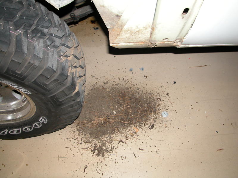

we cleaned up the axle & diff with a wire wheel as best we could without rolling it out from under the truck. The plan was to take it out and do an all-around clean, but in the interest of saving daylight we decided to leave it in when we were struggling with the steering linkage. If/when we get the body lifted off, we'll revisit this area and really get in there. Still 100% cleaner than it was before - about 1" of crap came off that pumpkin! Now some pics...
