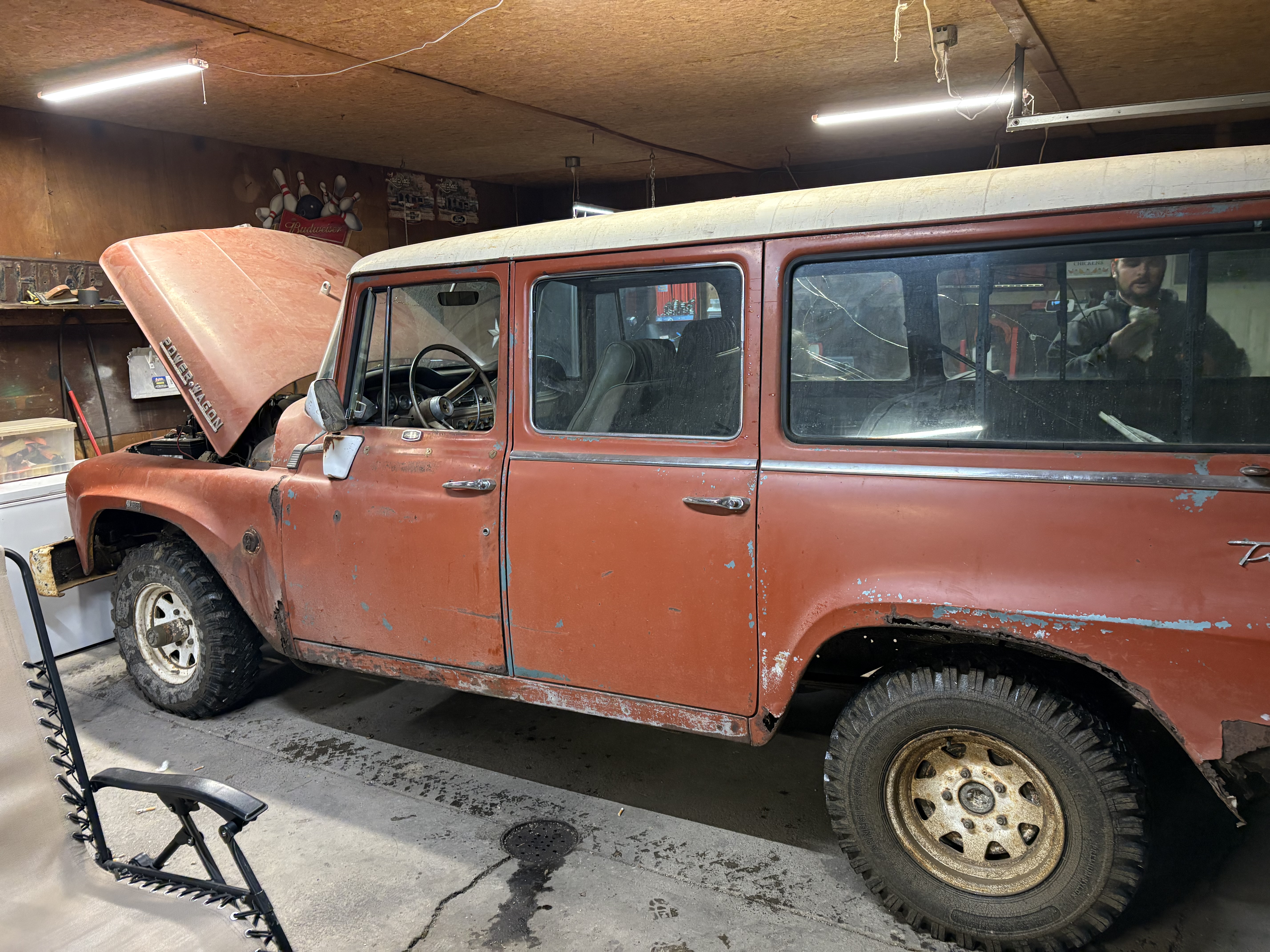

Evening everyone. I just bought my first travelall been looking for one for awhile because you do not see them around here much. So from what I have learned it is a 1966 1100A (door tag says) has the 304 and four speed 4x4 is has the closed end Dana 44 up front. The entire brake system is shot and does not function but man figuring out what style it is is proving confusing. The Id of the drums is 11” and braking surface is 2” what’s left of the shoes measures 11” across and 2” wide. The wheel cylinders it seems no one has it has the double piston style in the front not the single piston style I have seen around. Also have to find the wheel studs and wheel bearings because the only way I could get the drums off was pound out the studs. And I figure I’m this deep may as well do the bearings and seals while I’m here. Any advice of you experienced folks would be awesome.

Those are worn out! Call the store for the wheel cylinders, there's lots of things not on the web site.

Absolutely the brakes do not work what so ever the drivers side must have hung up because it burned the drum in half. Thanks I will give them a call I was just hoping to have some decent info to give them before I bothered to call.
