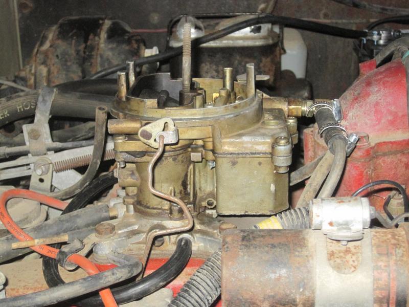

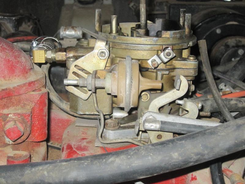

I started to take your advice (mayben), but I wanted to make sure that all my vacuum hoses were connected and/or replaced. (there is a part of me that wishes that this would be my problem with it dying......I know I'm dreaming.) as I was attempting to follow the decal on the truck, I started noticing that my carb is missing some items. I don't see the choke vacuum diaphragm. Also, I couldn't identify some of the parts that the decal was illustrated. I'm attaching two pics of my carb and here's the numbers off of it:
r6620 2a
441192 c92
0455
am I missing anything vital on this carb to get it running smoothly? Do I need to plug any hoses because I'm missing pieces? Thanks for your help. Btw, after I replaced one of the hoses, I cranked her up again and she ran for a while before dying. A couple of attempts of starting later, I sprayed some carb cleaner and she tried to crank. So, as you said mayben, it's not getting fuel. Can I try to drop the fuel bowl with carb attached to the engine or is that too risky?
