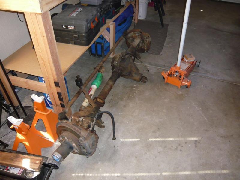

I have confirmed I will be picking up the Scout on Sunday. Im headed down to lodi after work to pick up my donor 72 blazer axle with confirmed flat top knuckles on both sides. Wont be till jan that I have the cash to have Jeff build it up, but it will sit in the garage til then. I plan to get the SOA done on the rear over the winter and hopefully get the sway bar kit installed on it. Next Saturday I will probably be dropping the t-case and seeing if I can sort out what exactly is wrong with the driveline. Would be great to meet some of you guys. I do provide beer and bbq for assistance. :)

I will have Jeff build my front. Chopped, turned, ARB locker. It will be ready to install when I get it back. While he is building it, I plan to get the shackle reversal and brake booster/proportioning valve swap done so it will be completely ready for the new front axle to just bolt in.

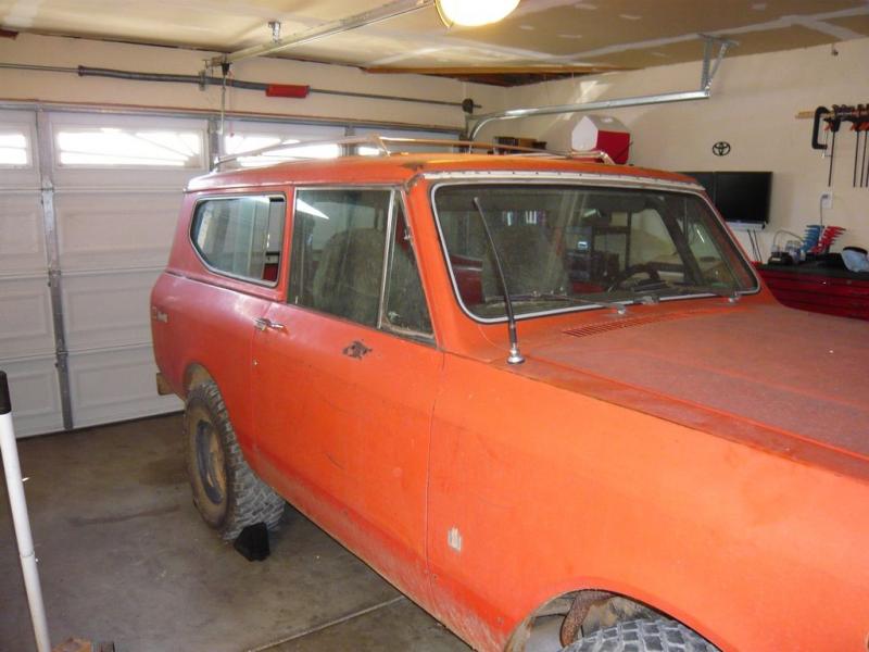

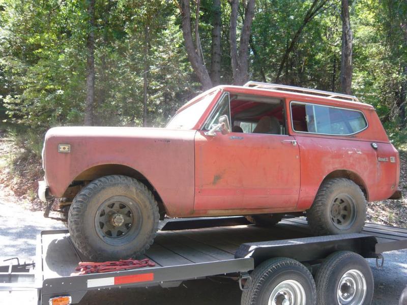

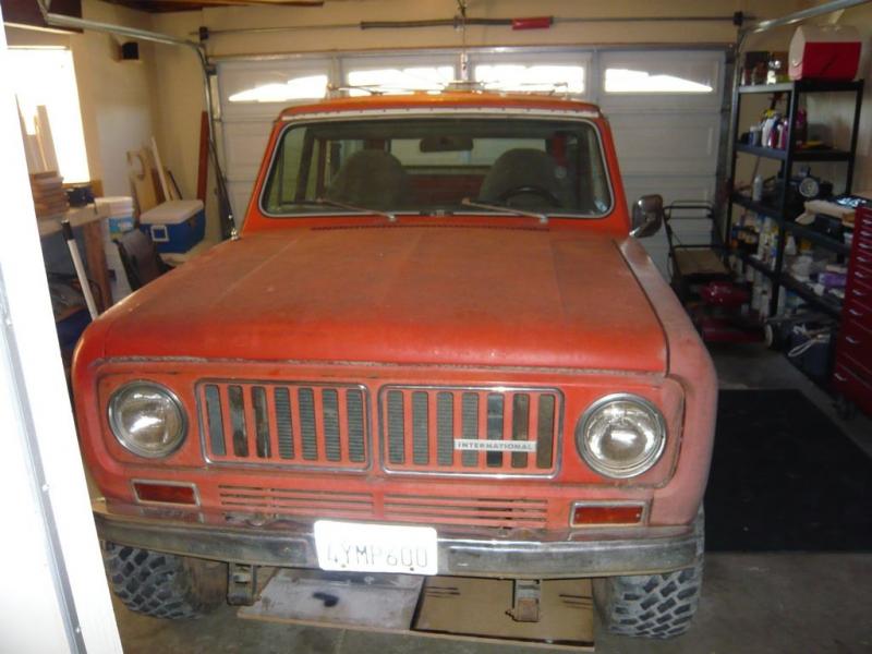

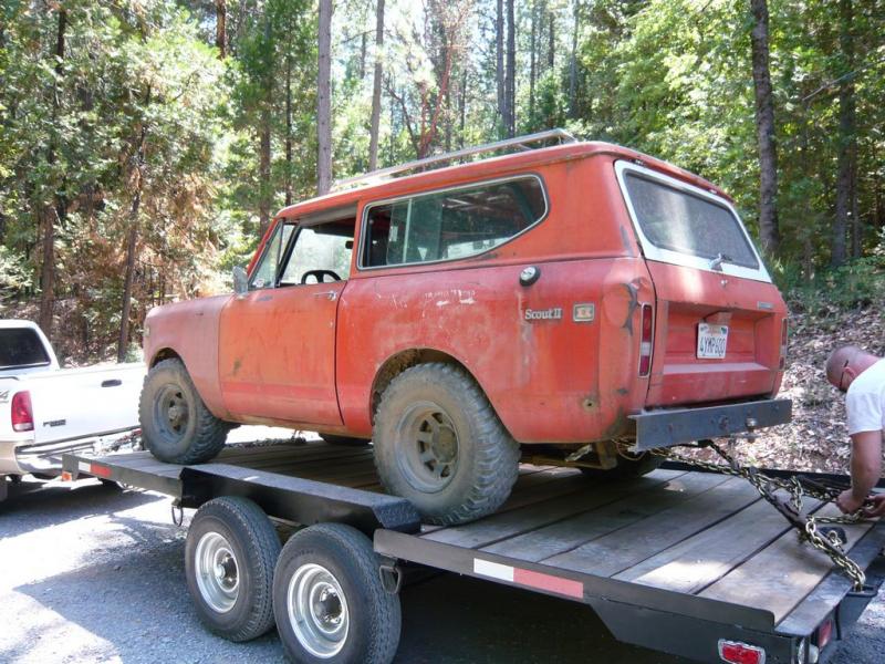

Here are the pics. Got it home on Sunday. Last night I gutted the passenger door. Dropped is off at my friends house. He will fill the holes from the factory molding. Then I will prep it and paint. I just gotta figure out where to paint at. My garage is way too dusty to paint. I tried to do the primer on the door panel tonight and there is way too much particulate in it. I cleaned the panel real good.

Primer is meant to be sanded. Take some wet and dry 400 and some water and go over the door. It will be glass smooth when done. :ihih:

not sure on your body work skills, but I would sand with some wet and dry 320 (wet) with a rubber block as it looks to have a lot of oxidized paint. Then if you want to fix the panel go for it and use primer as final filler and wet sand and your ready for paint. I would go one panel at a time so it not over whelming af6od.

Yeah.. Thats the plan. I really would like to get one complete piece done at a time. I will shoot another coat of primer on it tonight and wait till im ready to paint before I hit it with the fine stuff. I still need to find a clean place to do the final paint work. I have a compressor and access to a nice gun. But my garage is soooo dirty and the Scout has no reverse right now. So backing it out is a pain. Nice talking to you guys too. Im usually on during my commute time. Which isnt a lot since I only commute across town.
