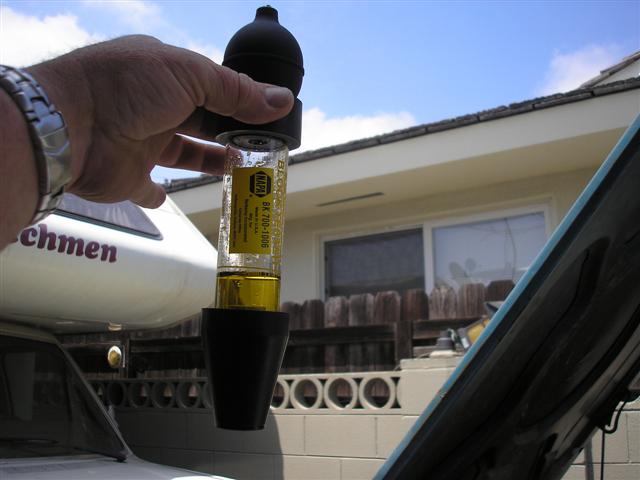

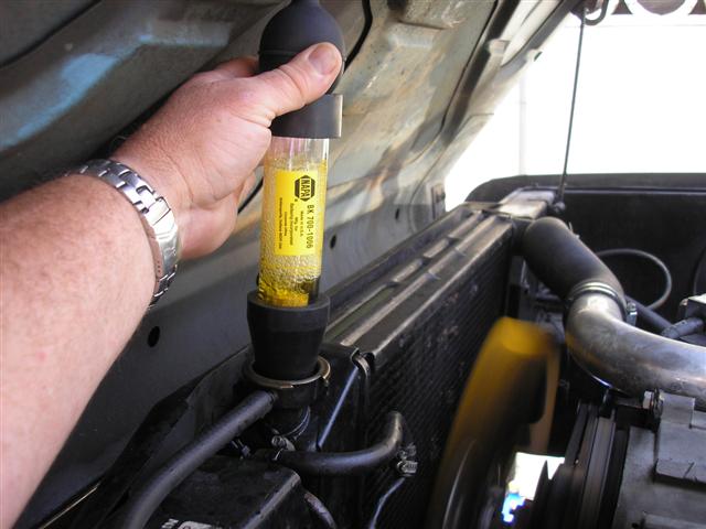

I bought a block tester today and checked the exhause gasses in the radiator. Looks like leaky head gasket, I bet right bank between 4 and 6. I could run a more specific test tonight by unpluging 2 4 & 6 and seeing if the liquid stays blue, then plug them back in one at a time to see when it turns yellow, that will narrow it down
Great diagnostics!!

Thanks Mike, that's high praise coming from you. This block tester is something new to me. But it sure tells the tale.
