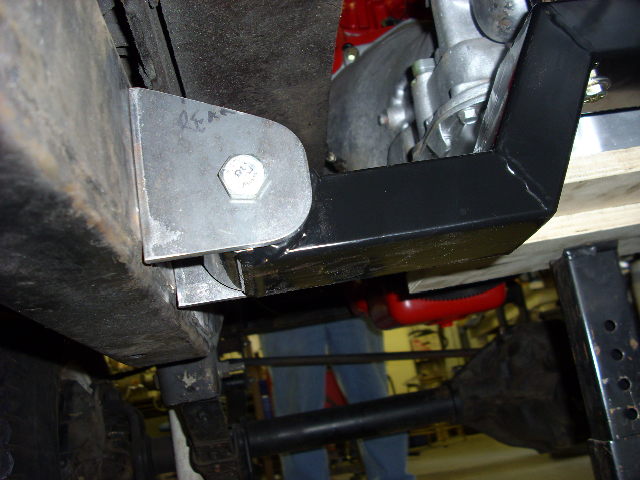

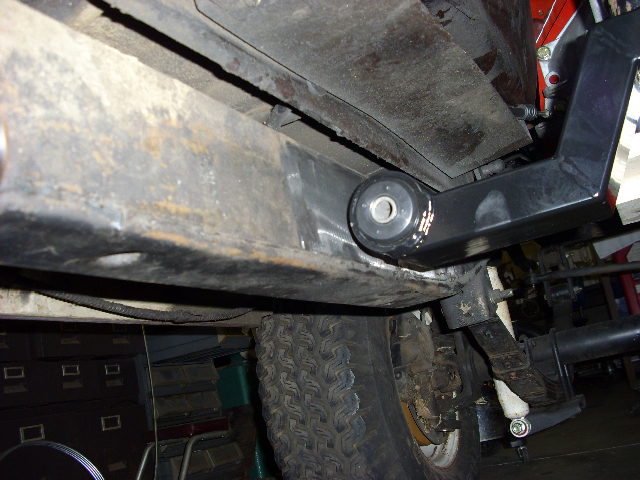

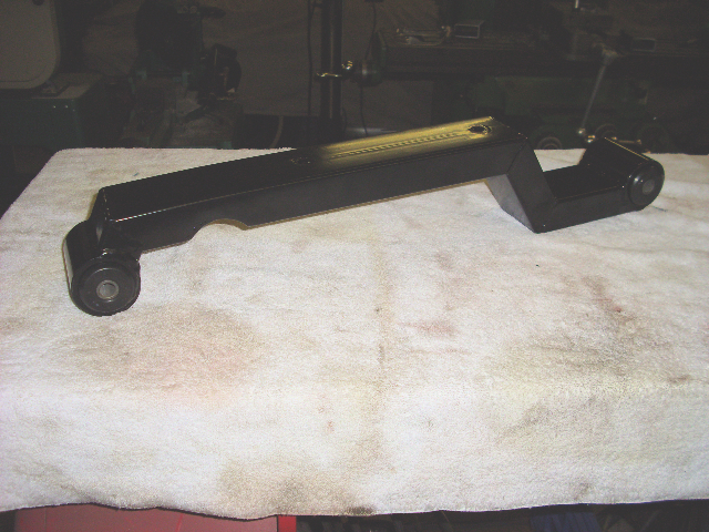

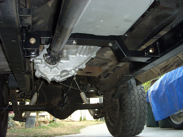

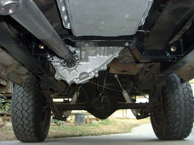

looking at your builds, you went with a different crossmember support. I used this one because everything else I found would put my crossmember right in the path of the front drive shaft. I've never crawled under a Chevy to see how GM did it, but this seemed to make the most sense to me. Also, I wanted a path for the exhaust to go. Its a '79, and here in socal, I've gotta deal w/cats. I found a cool 2-into-1 cat w/2 1/4" in and 2 1/2" out that will fit in the stock location. As soon as I can drive it, its off to the muffler shop. I'll be able to post up the entire build then. Plus I can get some better pics when its up on the rack that will better show the entire drive line.
