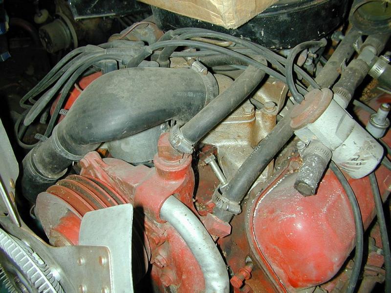

Anyone have a pic of the factory routing for plug wires on sv in a Scout 2 with a prestolite electronic dizzy im sure the others are close, not trying to be a perfectionist here just figured they routed em this way for a reason the wire set I bought is for the 80 model sv in a Scout 2 with the presto dizzy but it only has 3 straight boots for the driver side bank . Dont the wires go over the water neck? Or am I mistaken . Any help and a pic of the wire route would be great thanks in advance brad
Yore in luck dude.
Here's pic I took a few years ago of a 1980 345 pullout from an sii in the collection at ihon. I took many shots so I'd have 'em for documentation but I'll be dam if I can find the rest of 'em.
This is the bastard motor that had the engineered cooling system bypass eliminated beginning sometime in the 1979 production run.
This is a bone stock motor, even the plug cable routing has not been disturbed.
