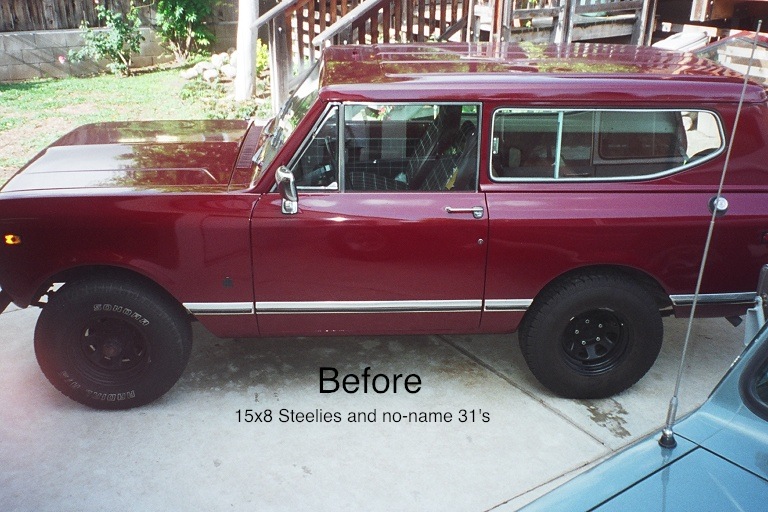

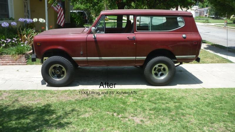

My experience has been a happy one with the skyjackers. I have a '79 w/5" shackles, new body bushings, and 4" skyjackers and the ride is fine. Better than my '74 with the same mods, but using a 4" rancho lift. Both trucks run comparable 33" tires and caster shims (4 degree). No sag after 5 years with either system.
I'll post up some before and after pics later today. Pics speak a thousand words.
Edit: here's the pics.
