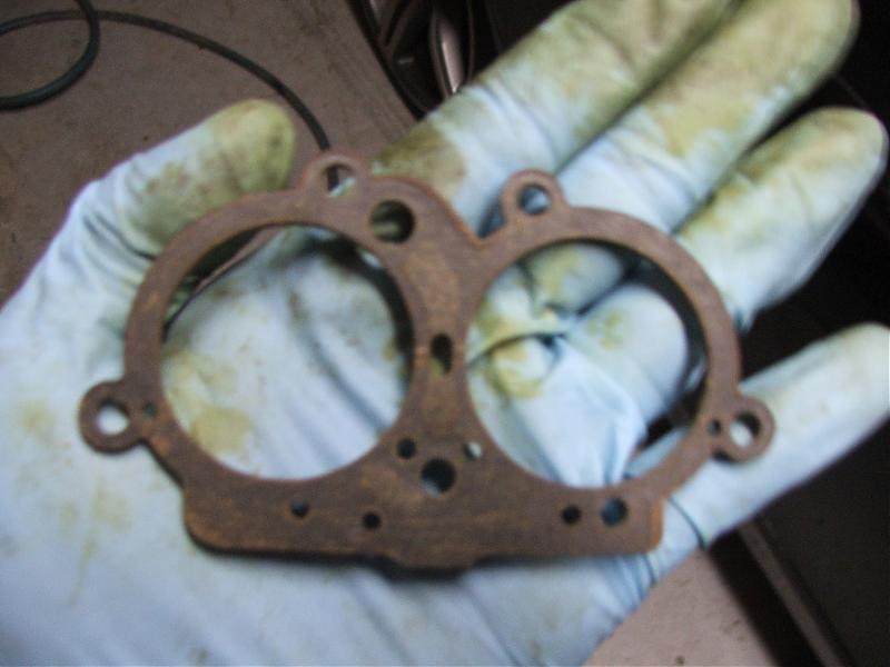

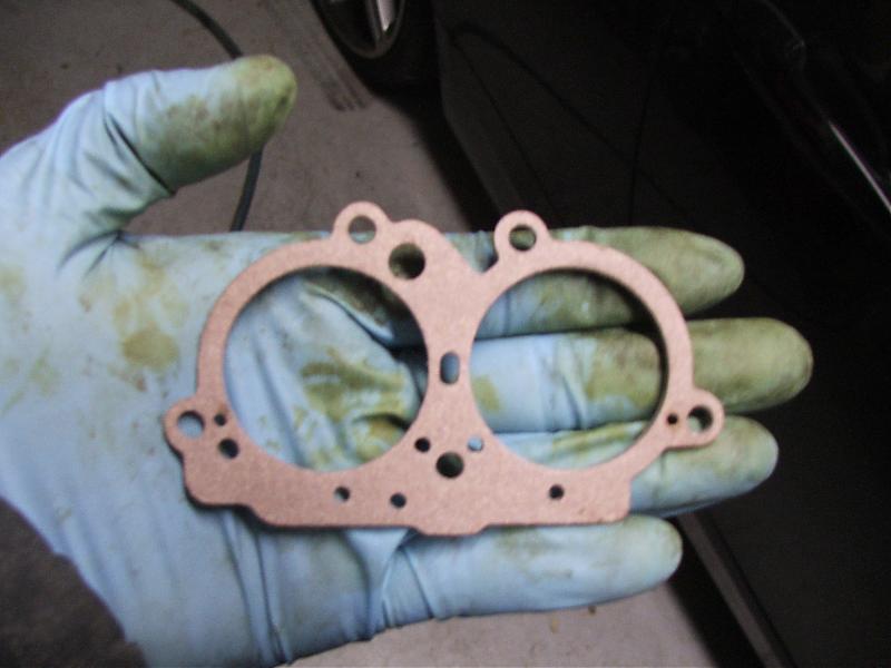

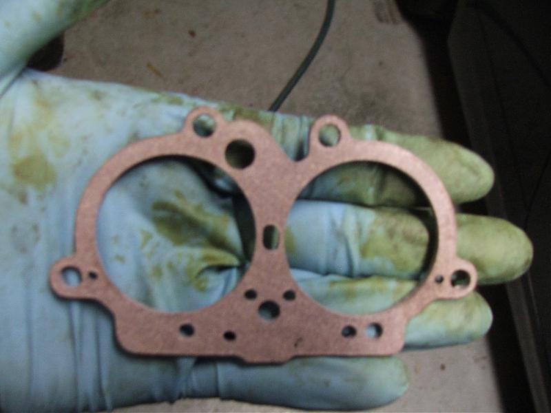

I have bought a gp sorensen 96-350a kit that I am not sure if it will work . After disassy. I looked at the old gaskets and found a port that looks like it would of been leaking .

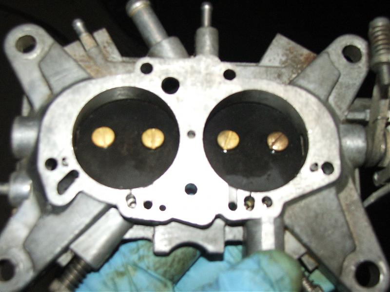

Ok. I have looked at the post and the gasket differences. This is a Scout that I just bought and was told it had a carb problem. I could get the truck to start but had to hold the choke shut to do so . So I took the carb off disassembled it and found the gasket problem . My question now is the gasket in the post that says correct gasket is the same as one in the kit that I have but when putting gasket on the carb there is a port that is being blocked by the gasket.. Should it be blocked??
Yes!
The gasket must block that port on the throttle body used on the IH-version of that carb. Otherwise you will have a major vacuum leak.
Again, both of the carbs that I used in that tear-down sequence were assembled incorrectly, one had a big vacuum leak, the other had the "leak" filled with red rtv but still leaked!
I just did a gps lookup on the carb kit p/n you posted...the photo which accompanies the lookup on the gps website shows to be the exact same kit as the standard hygrade 929a which ron alluded to in his posts. It should be, as the gp sorensen "brand" is a part of standard motor parts umbrella operation, a simple re-box of the same sealed kit packaging with a different overwrap. That kit has both throttle body gaskets as you mentioned, and also has both base gaskets, the four hole gasket if for chrysler apps of that carb, the "heat dam" gasket is the correct base gasket to use on the IH application.
