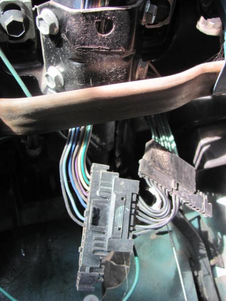

Hey all, I'm hoping someone out there can help me out by donating a turn signal switch for a saginaw/GM steering column. My '76 terra is currently without, and it looks like the switch is actually in two pieces inside the column. If anyone has a known good one they would like to donate, please let me know. I'm a college student on a very limited income, so I would only be able to pay shipping and maybe $5... I know, I know, I am looking for charity on this one.
Yea, I do still need a switch. :/ I pulled one off of a '75, but it has the old-style connector, the wire colors and pattern is exactly the same, but it doesn't fit the connector on my harness.. I really don't want to butcher the wiring to get to fit, since the terra is almost entirely stock.... But I digress- if you have time to post a pic of the switch and the connector, I would greatly appreciate it. Thanks! (also, whereabouts are you located?)
Here are a couple pics.
If you have one already and the wires are the same, and the terminal ends are the same, it is easy to remove the wires from the plastic plug and install the wires on your old plug...
I think to get the switch out of the column the wires have to come out of the plastic plug anyway....

You can wiggle it up and out with some removal of certain parts of the steering column, cant remember which ones, did it awhile ago, its tricky but doable.
