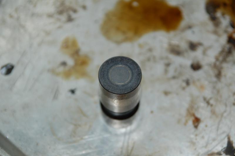

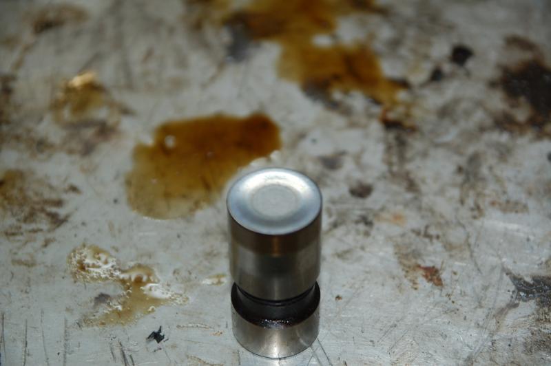

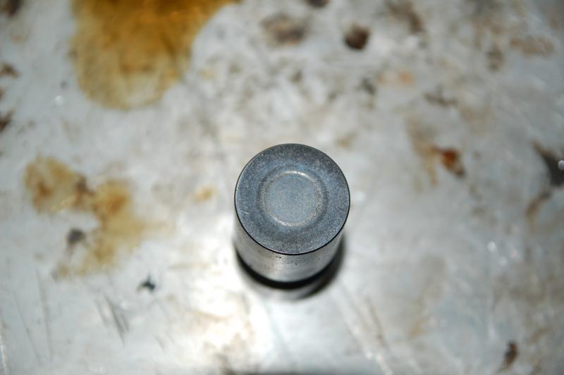

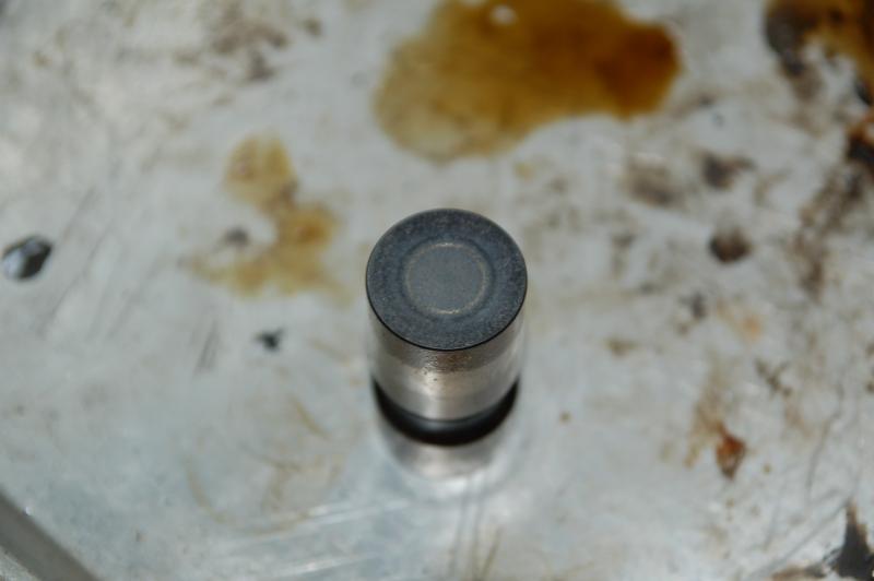

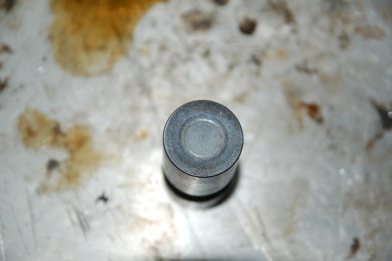

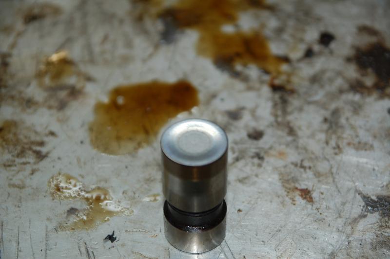

I can mail you 1 also...hope its a good lifter, or your wasting your time,,is the bottom flat ? No concave ness ? Jeff
Unfortunately, very concave, the odd thing is that all the passenger lifters were identically concave, pics are all of same lifter, also odd (to my inexperinced eye) is that the bottom of the lifter is completely uniform

Dude, you really really really need a new cam and lifters. The metal grinding of the lifter and cam lobes will destroy the rest of your engine.
Robert Kenney
Super Moderator
That curve is indicative of a lot of miles. That is not a catostrophic failure event occuring but the normal wear process. Is it desired? No but if you maintain the lifter location integrity, they could run for another 100k miles.
The so called metal coming off of them, is not anymore than a normal running engine..
Now there is a flip side to this, if you end up needing new cam bearings don't use the old cam ans lifters. The work to replace the bearings is the biggest part of the project not the cost of a new bump stick kit...
If you do need cam bearings I would roll in new rod and main bearings. You May even install new rings and ridge ream the bores if needed.. If it doesnt use any oil just install new cam, rod, and main bearings along with a cam and lifters..

With that much of a cup the cam lobe is also very worn. So yes while the engine May run it probably won't run very well due to reduced lift and will likely make a lot of rattle in the valve train.

Is it just an optical illusion or are those lifters concaved about .125" in the middle? If all the lifters and cam lobes are like that it adds up to a lot of metal.
