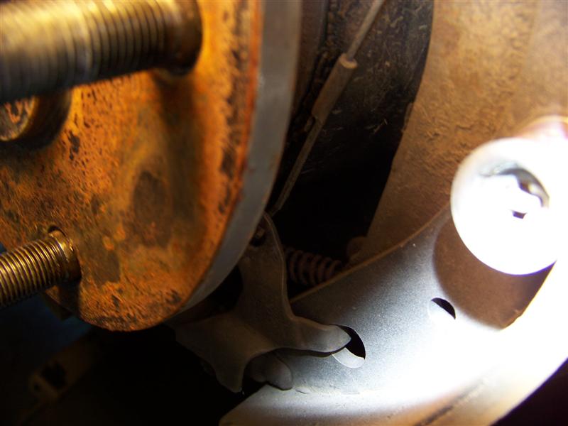

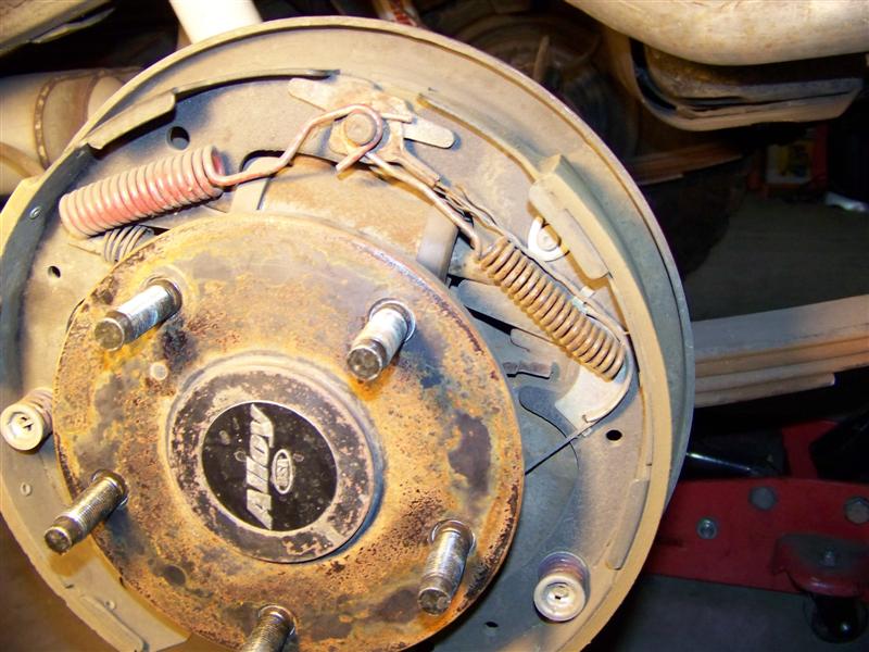

Trying to find one, I'll be calling today, Jeff
F Franked Member Jun 15, 2011 #1 Trying to find one, I'll be calling today, Jeff Attachments Jeepscout brakes 001 (Medium).jpg 53 KB · Views: 328 Jeepscout brakes 003 (Medium).jpg 93.6 KB · Views: 352
ronmc1954 Member Jun 15, 2011 #2 Need to know what vehicle we are looking at. My 74 & 75 scoutii that cable comes with a brake spring kit I got at napa if I remember right. Ron
ihpartsjeff Administrator & Owner Staff member Jun 15, 2011 #3 The cable you need is part of the brake adjuster kit we sell - brake adjuster kit for Scout II, truck, and Travelall - International Scout parts
