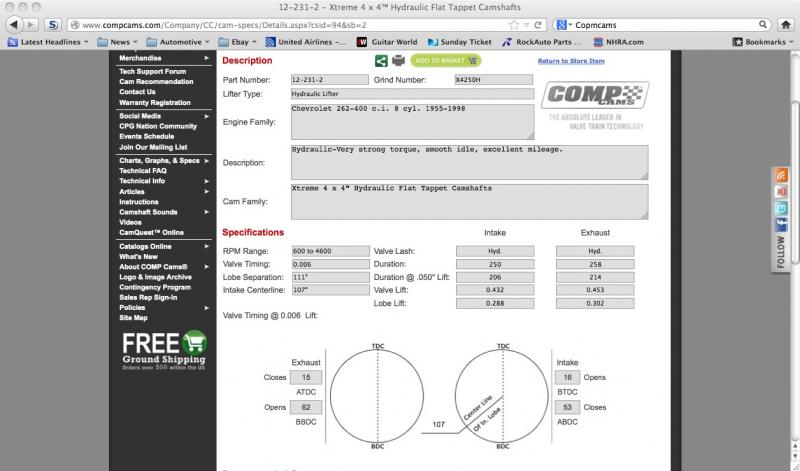

Anyway, all is going well with my first engine build as far as I know. That said, I'm worried about the cam in the motor as it needs to pass smog. The mystery motor came with a comp cams 260h cam.
Does anyone have info on the smogability of this cam?
This is the comp cam 260h card from their website:
Your expertise on passing smog with a bigger cam is most appreciated!

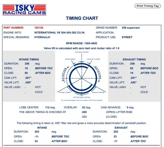

Here's the specs on the cam I run in my '79 345. The great thing about comp cams is they'll grind any profile on an IH blank. So I picked one of the Chevy extreme 4x4 grinds and had them put it on an IH stick. It passes no problem using a q-jet, air pump, egr and a 2-into-1 exhaust thru a single cat. Your cam doesn't look too much different, and I'd say you'd be ok.
I also run an isky grind in my other 345 Scout. Its a '74, so smog checks don't matter anymore. But there was a time when it was tested biannually, and it too never had a problem with the same q-jet setup.
You can compare yours to see its pretty close. I seriously doubt it will have a problem.

Ohhhh, that cam is big indeed. You might be able to get her to pass with some tricky fuel calibration but I'd say step it down a notch or two. Intake duration should be close to 206@.050 or less with 112 lobe centers or larger.
If you were to chose a good smog cam the split duration isky is nice. 202/204@.050. 112 lc stick her is straight up to 4* advanced. Lemme look up the number. Isky-190125-26
should be fine with a good tune. Check out the store or give the shop a call.

Well first off, Robert is right about that cam you have. I missed the intake duration. 212 is probably fine on the exhaust side, but its pretty meaty for an intake number. I'd still put it right on the line as far as passing. The numbers below sort of bear this out. There's quite a bit of leeway between the cam I have in the '79 and how much farther I could go. I would think you could land near the top of the values and depending on your carb, dial it back enough to pass.

Remember duration is only half of the emissions problem. The other is the lobe center line. The split duration is ground at 110 while the single pattern dealbreaker has is @ 112. The dual pattern will have more overlap and make more cylinder pressure then the 112.
If you install the dual pattern straight up it will make more hp and have longer legs. Advanced 4* I would worry about cylinder pressure being high. Run the intake at 108 or 2* advanced and I bet you love it...

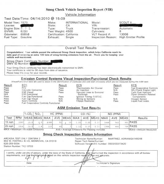

Dealbreaker, thanks for the smog info! I see max, ave and measured. What is the allowed (the max)? I have the exact same setup,'79, 33's, 3.54, 727, 345. You know we are in a special little world when you all know exactly what that string of digits mean! Anyone that knows what that string of numbers mean but doesn't know the color of their wife's eyes...rut row.
-jack
Took me a min to find that page. Here's what the little numbers say.
at 15 mph
Hc max allowed: 189
measured: 10
co% max allowed: 1.33
measured: 0.00
nox ppm max allowed: 1448
measured: 901
at 25 mph
Hc max allowed: 113
measured: 7
co% max allowed: 1.13
measured: 0.00
nox ppm max allowed: 1308
measured: 795

Dealbreaker, thanks for the heartening numbers. You passed with lots of margin! The nox were the closest to limit but still plenty of margin. Thank you for digging that out.

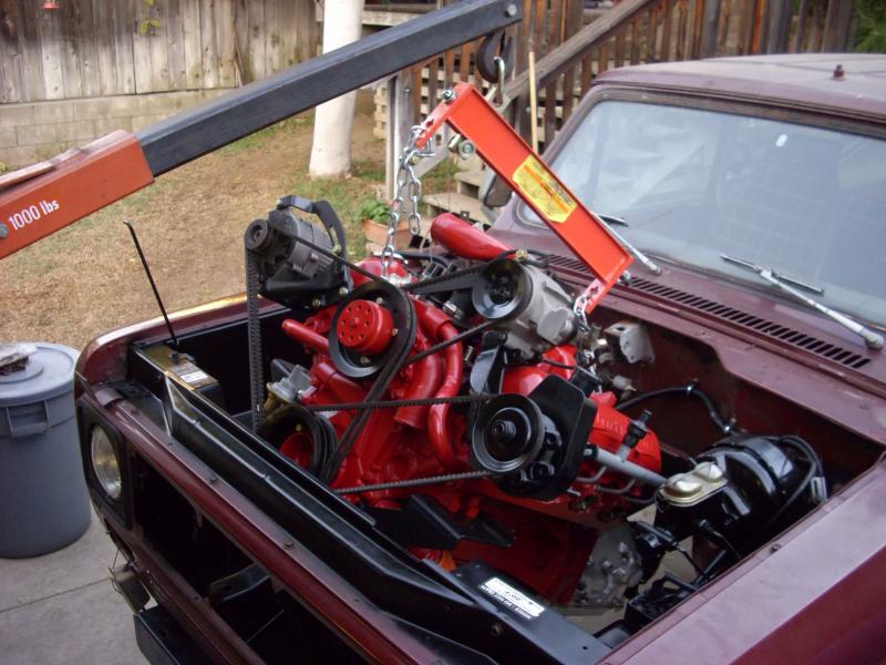

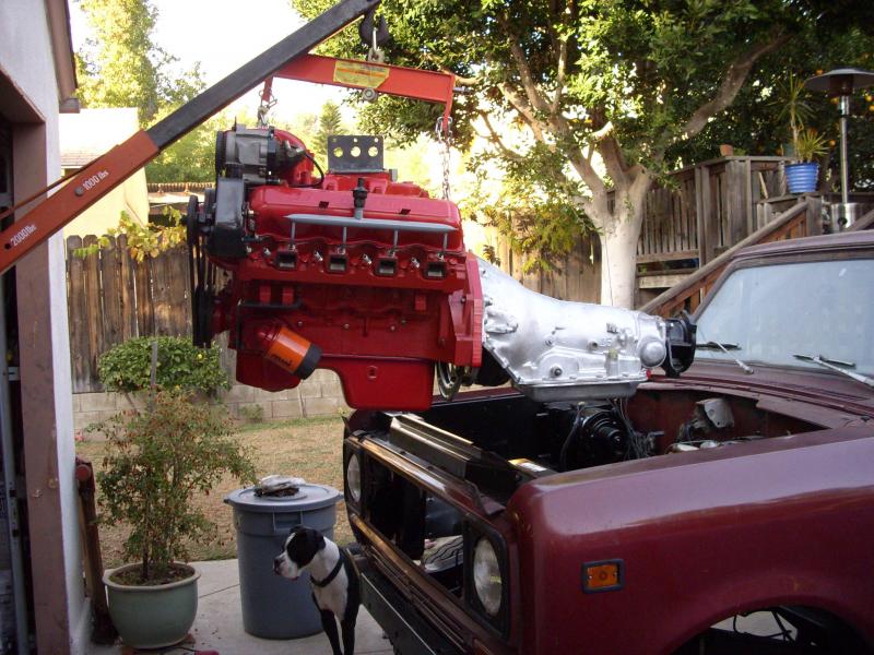

Be careful dipping your toes in the water around here. The last one I did started as a simple head gasket....
