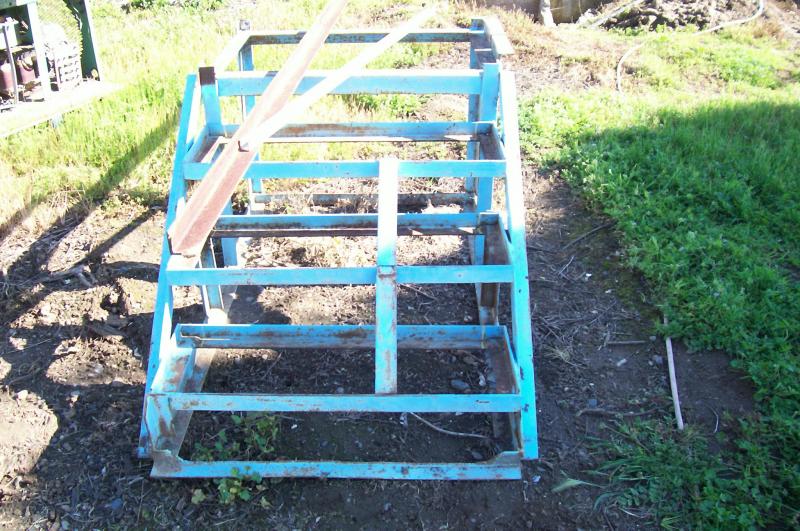

I did some more work on my RTI ramp. I started with some homemade rv stairs my Dad overbuilt. This first pic. I was thinking about just adding some metal to make a ramp. Then I search online and found that the angle was way to steep! You can kind of see the old steps. We had 2x6 wood down for the steps.

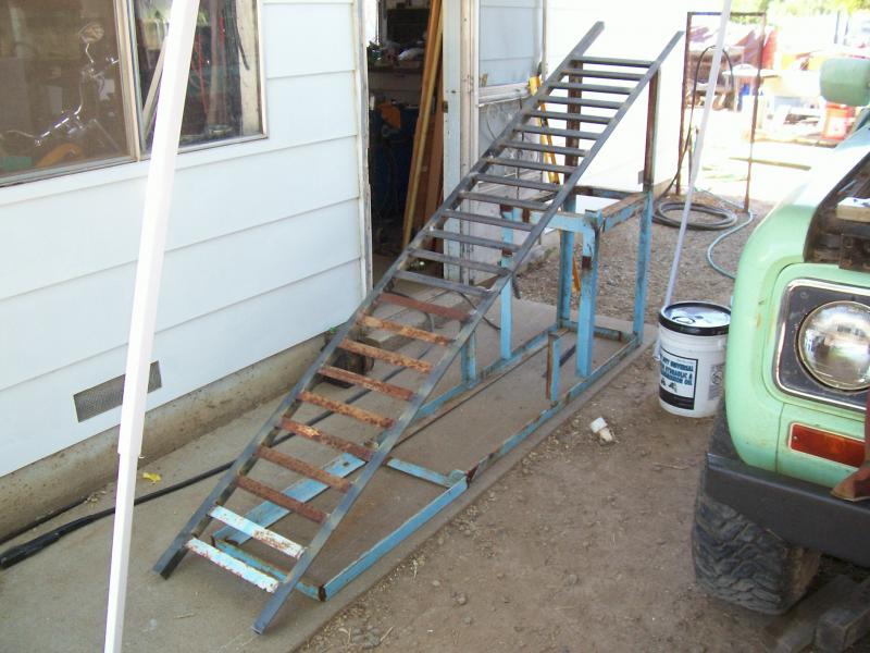

This is how it ended up. It’s still not done. I have to put the braces in. I’d also like to put some out riggers on it.
The ramp is 1.5” angle 3/16” thick. Cross bars are the same angle, 4.5” on center… for those stock scouts:icon_mrgreen:
I don’t have all the dimensions right now. I will post them later. The ramp is 9ft. Long by about 16“ wide. Height is 4’ 3”. The angle ended up around 27 deg.

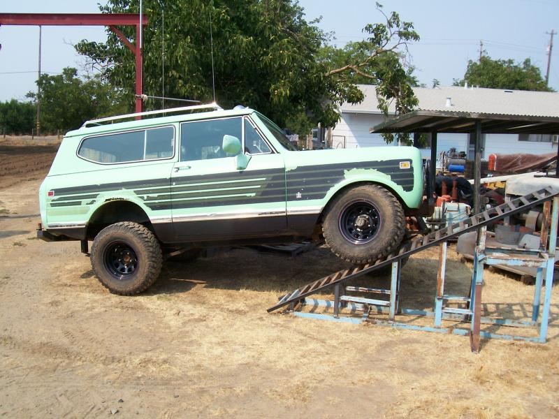

I got the braces welded in and some outriggers on it. I got my brother to take pictures while I drove up it!
Doesn't look like you'll have any problems with driving off the end of it. Jest keep'em right side up.
