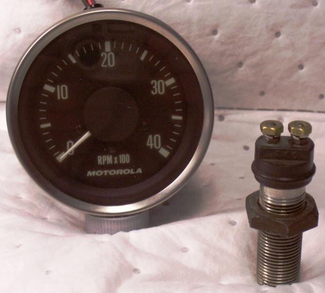

. I phoned around and found a motorola 7st24013 0-4000rpm tach and I went about installing it. I ran it until around 1995 when the Scout raised the white flag at 350,000 miles. In the interim I had purchased a 1980 diesel traveler for my wife and the Scout II entered the “parts Scout” phase of its existence. The tach was one of the many parts I pulled with the engine with the idea of installing it in the traveler. Yes, good intentions!.........., say no more!

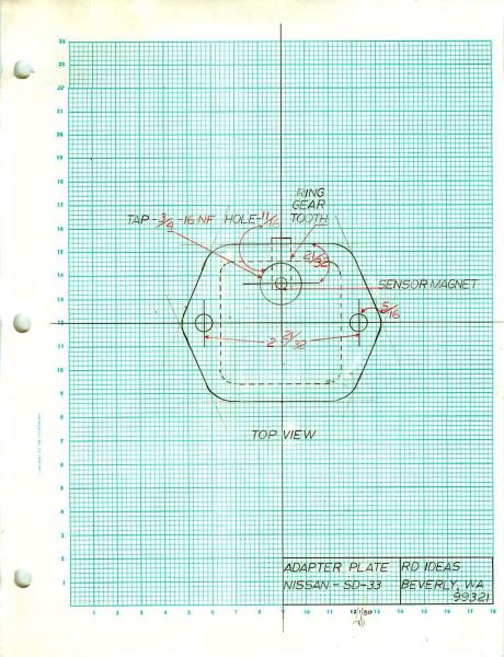

I looked on line for wiring information but came up empty handed. I did learn that prestolite bought out motorola instruments and changed the p/n to 7st24062s. Then there was also a reference to leece-neville sales no.104536a. I found about a half a dozen folks looking for wiring information. Prestolite has since discontinued its tach product line. I see this tach on ebay every once in a while but never with the sensor or instructions.
I woke up just yesterday and walked right over to where the instructions had been gathering dust. So I thought I would post up the instructions sheets in the hopes it would show up if someone else were to do an internet (thanks al!) search.:d

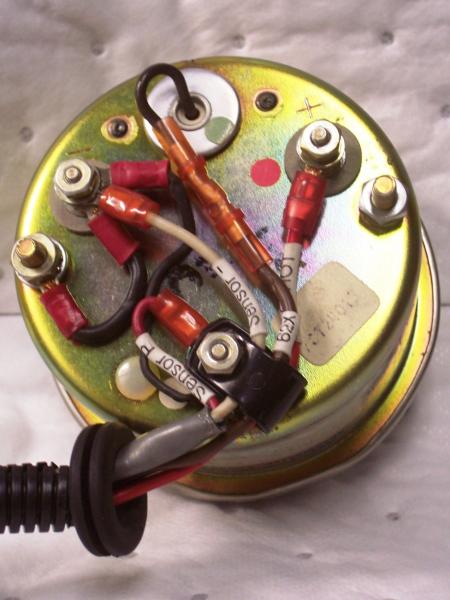

here are a couple of current pics. I used the shielded cable only because I had some. Everything is wired on the tach and inside the Scout, mounting bracket installed and firewall grommet drilled. I’m waiting for the mounting plate to come back with some powder coated parts. So it should return to service in short order after a mere 15yr hiatus.:d
