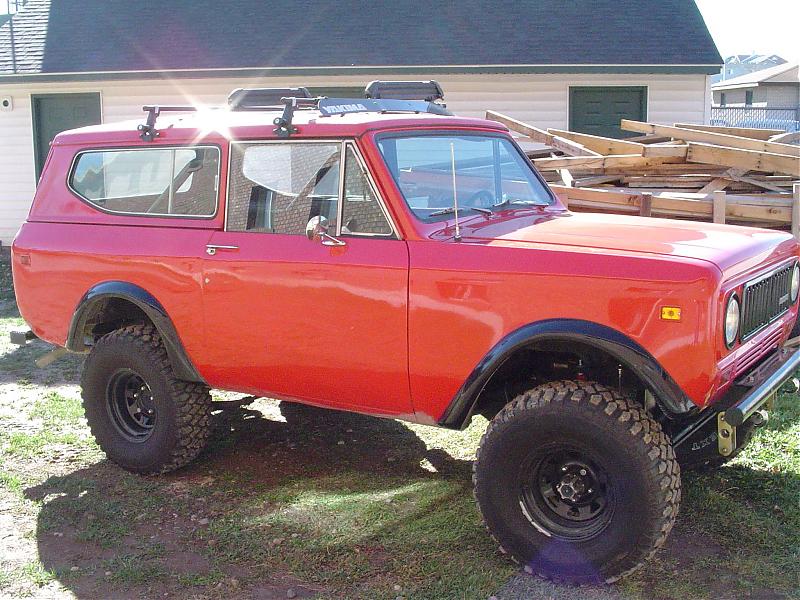

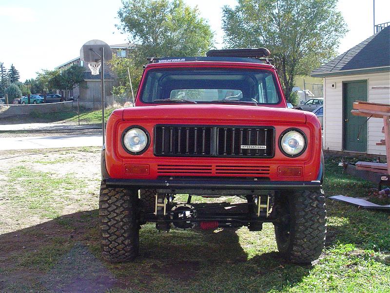

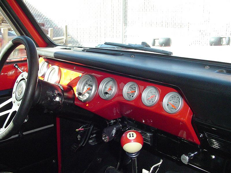

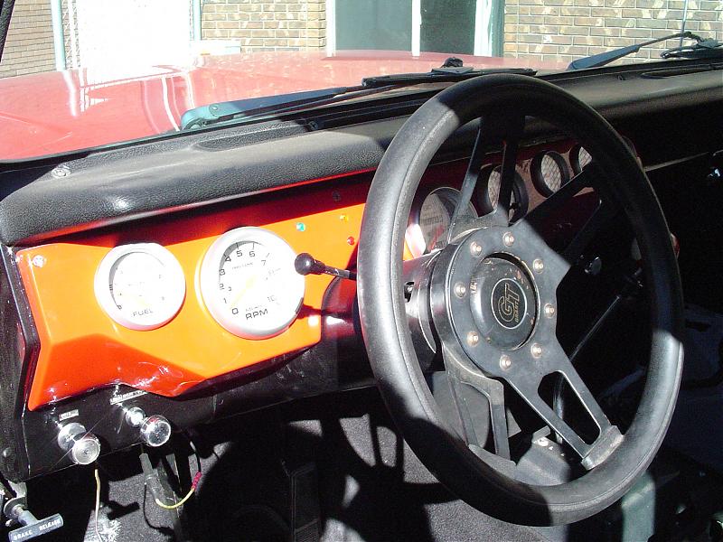

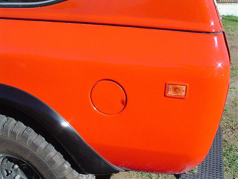

This my 74 Scout II. I bought it in rexburg idaho, from a case tractor dealer. When I got it it looked great from the outside. Two years later I found 1/2 of bondo across the back fenders, and the body was rusting out. Needless to say you start out replacing a couple of fenders and you end up with this. Now it has a 4in lift spring lift, 33x12.5 meats, custom dash board with ultra lite gauges, tuffy center box, h4 conversion headlamps, new rear fenders, custom front bumper, new paint, and a gas door. I got the gas door from a Ford explore and welded it in on a brand new fender. The dash is cast out of fiberglass. We used led lights for indicators. The new gauges work great and you can read them at night which is better than most. So take this as a warning one little project can become one big project when you are talking about a Scout. The project does not end here though, I am working on new stearing rods, an addition to my dash, and hopefully a new motor in within the next little while.
