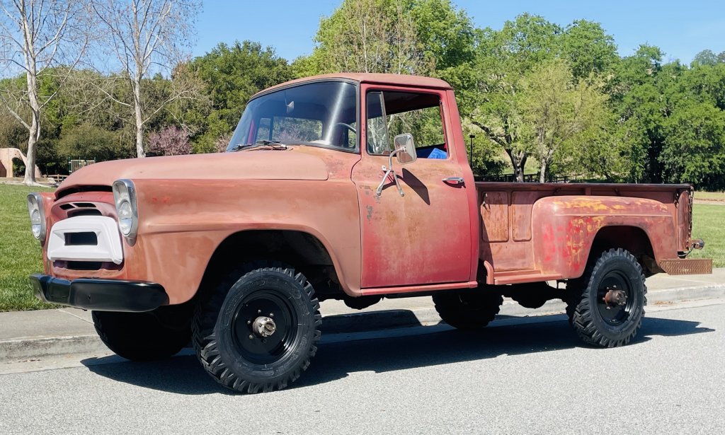

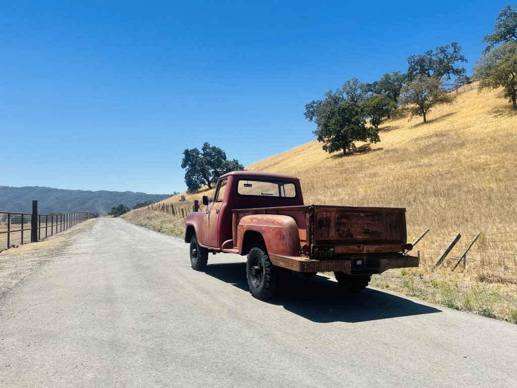

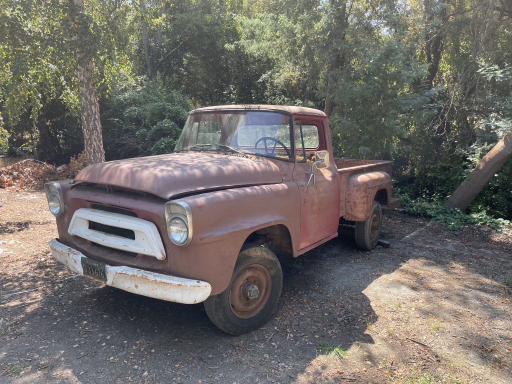

My 57 A120 4WD dust off
Luv2fish
Almost a year since purchase so here are a few updates…
Tires and rims were the biggest $$$ addition so far and I’m starting to enjoy it more now that it’s turned into a driving project .

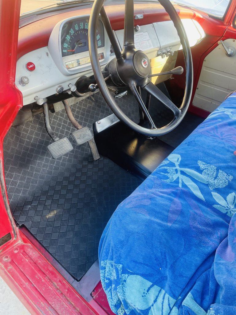

Wish list items include seat upholstery .
Been challenging but fun looking for parts and IHP America has been a big help so far !
first pics …
a year later

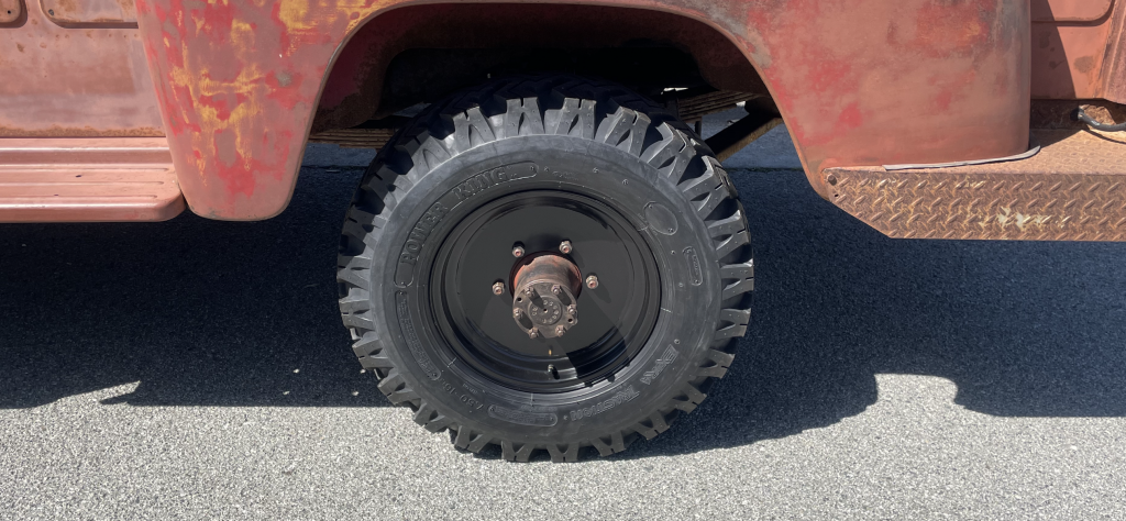

Wide 6 wheels? Where did you find non-split rims?
Truck originally came with 17.5. “ one piece steel rims… Nice rims but tires are extremely expensive “ if “ you can find them . So I had custom 16” rims with the big 6 lug pattern made
I can get you the info if your interested.
Tires are 7.50 x16 Power Kings .
here’s a better shot of the wheels…

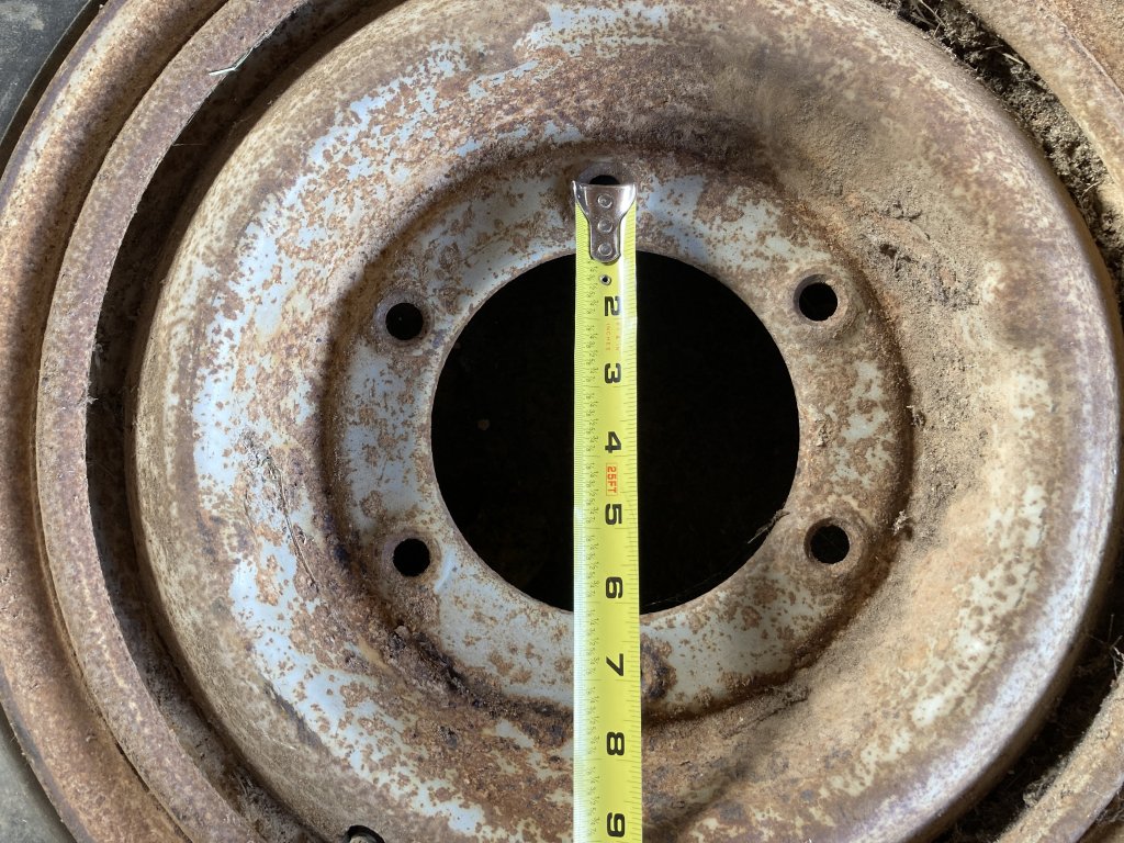

i like these wheels and would like to find a set to fit my 66 1200 PU. Where did you find these? THanks

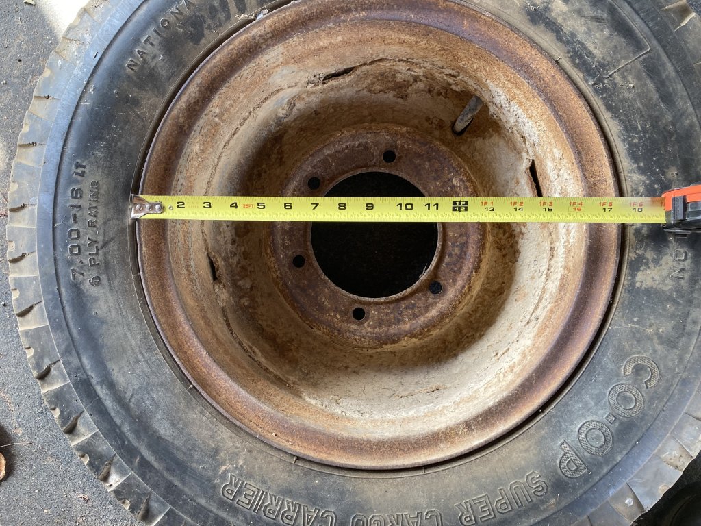

Thanks. Is the lug spacing 7.25 inches? As for the name being posted, would you mind sending an email to me with contact info? here is mine Tomcroft51@yahoo.com
I am hoping to replace the ones in these photos

Had a place out of So Cal make them . Very happy with them. Cost was 228.00 each for 16”x 6 “ and that included powder coating.
Not sure if I can post the name of the outfit here or not .
In this case please do post who made these for you as we are curious. We have used Stockton Wheel in the past, but they are hard to reach and take a long time to get anything done.
