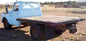

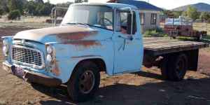

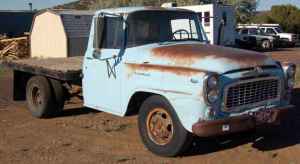

Soo I decided to make a little thread on my rig, unfortunately iv missed allot of pictures along the way but here is a little about here. Sence I live in az my truck was bought originally for little americas hotel up in flagstaff az. It was there wood truck cuz they new they needed IH power:smilewinkgrin:. It came as the flatbed that's on it with wood stack sides that I have, same original wood "sorry no pics". It came with the v8 266 which was ahead off its time by a year really. It came with the dually rear end and overload springs and my door plate says its rated at a ton and a half. They sold it to some cowboy fella who owned for a bit and he sold it to the guy I bought it from in August 2012. I saw the add on craigslist told my Dad I wanted to go see it and he grinned going well lets go.
I fell in love but it needed work from being neglected. It has 83 thousand original miles, with the t98 4speed tranny. Brought it home and this is what l looked like! Not to bad for the year the worst is the floor because the po had carpet in it:( this is my first IH by the way lol soo I was a newbie at 16 years old. I needed a truck to be a strong dully so I could haul my sammi on the bed or other toys and still pull my boat to the lake or the camp trailer out camping soo the goal here is to multi task haul plus I liked old trucks all ways been around them my whole life.

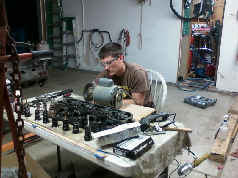

Next I got it home and realized it was just filthy soo after a quick run down on what was what I stripped it, inside and out, the carpet,seats,bed and everything was off in 2 hours it was home lol from there I decided to do some research to see what I was really working with. After fighting so much grease I said I had enough and whipped out the tranny jack and engine stand to really clean her up and repaint the engine compartment while everything was out.
I got the engine bay sanded cleaned and painted with good restolum black auto grade paint, fenders, frame and firewall were looking good! As I stared to power wash the engine and tranny I realized from sitting so much the seals were shot and I prolly should take a look inside the motor to make sure everything is squared away mechanically.

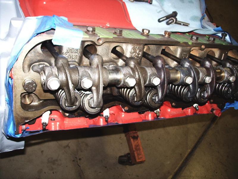

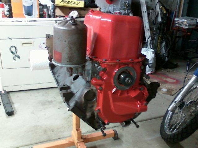

Soo after buying a full gasket kit I tore into it, boy what a caked on oilly mess. I pulled the heads to find the pistons and walls like brand new not a scratch ridge nothing just clean honing marks:smilewinkgrin: the heads, rocker arms, all the tins for the motor and oil pan were caked from old oil soo off they came disassembled cleaned and sand blasted.

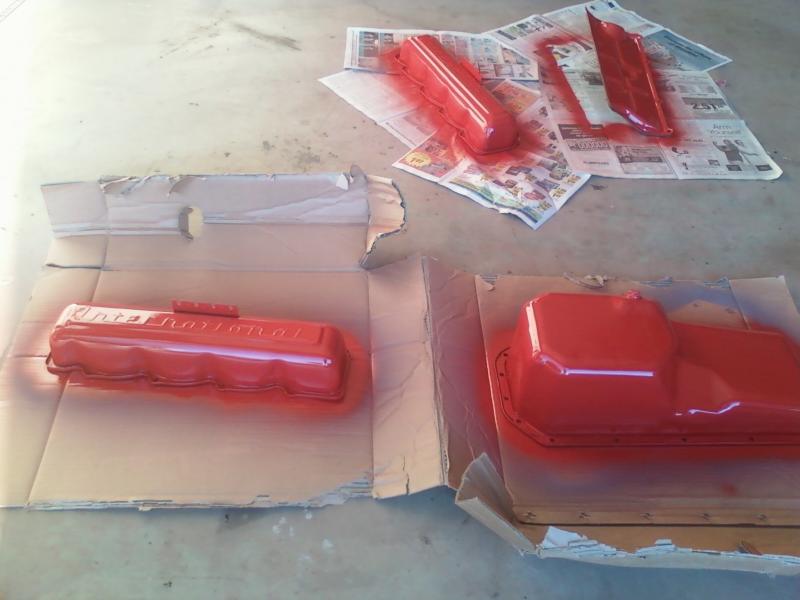

This took some time because when it comes to clean I like to eat off it soo sandblasted, scrubbed, 4 coats off primer baked in oven, 3 coats off red baked and they turned out good and clean for me.
I decided the valves weren't worn after gauging them soo I got every spec off carbon off them after 3 days behind the wire wheel they came out as brand new! Then I went old school and gave them each couple rounds off fine grit valve lapping by hand each valve to its port.

The valves were lapped perfect but I caught the smell off some needed performance from IH parts and before you could say isky, I had the isky towing cam, comp cams valve springs and locks and new lifters arriving at my door:smilewinkgrin:

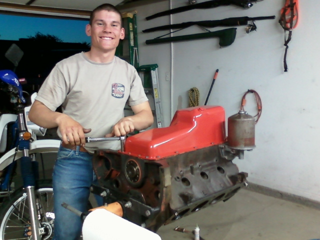

I took out the old cam checked the dreaded cam bearings to be all in check!!:shocked: perfect good to go, installed the cam the day it arrived. Sense I went this far I whipped out my dremel grabbed the old gaskets and decided some port matching was in need soo 2 weeks later "slow process" I had intake and exhaust paths ground, matched and followed up by buffing compound to polish! It was long but worth it. Now with heads done I reassembled and worked the rocker arms cleaning cleaning and cleaning. Once done all back together I bolted them up to the engine with the fell pro permtec head gaskets. I made sure everything was right up top and in spec to torque.
For the bottom end I went ahead and rebuilt the oil pump weather it needed it or not might as well and got the bottom half buttoned up after that and a new rear main the pan went back on.

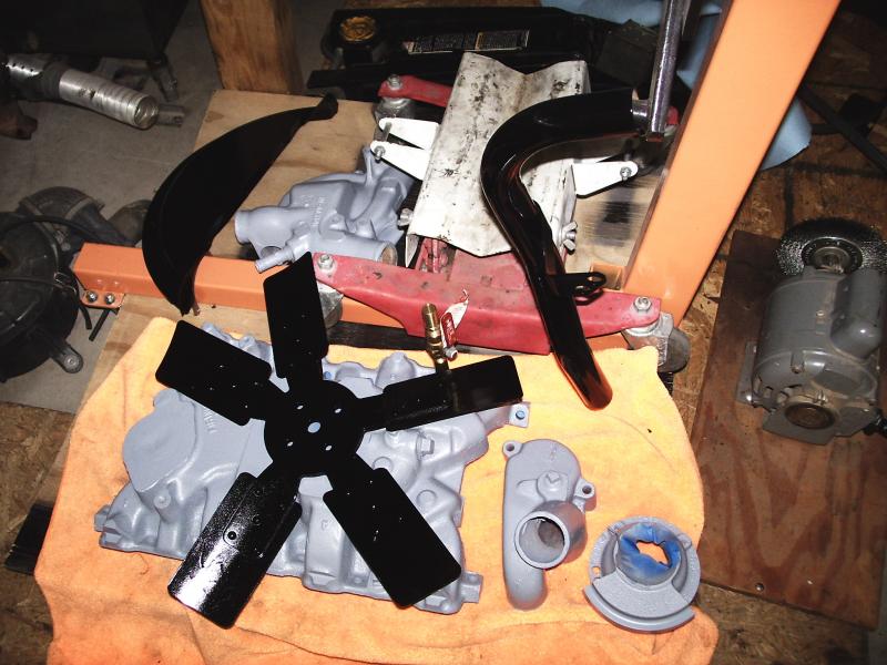

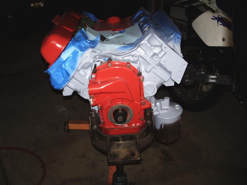

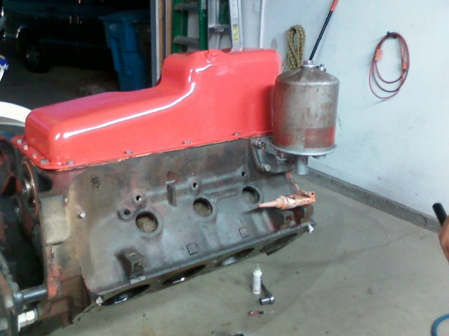

Now with the engine almost done, it was time to pain the rest off the block, which meant new freeze plugs all the way around, by the way were filled with crap in the block so a vacuum,wire and compressed air had her cleaned up in 4hours next sanding,wire wheel, 4 coats off primer 3 coats off red:)
the rest off the parts where all hand cleaned up and painted, I mean every part got a new shine to it. I like the look off clean paint.

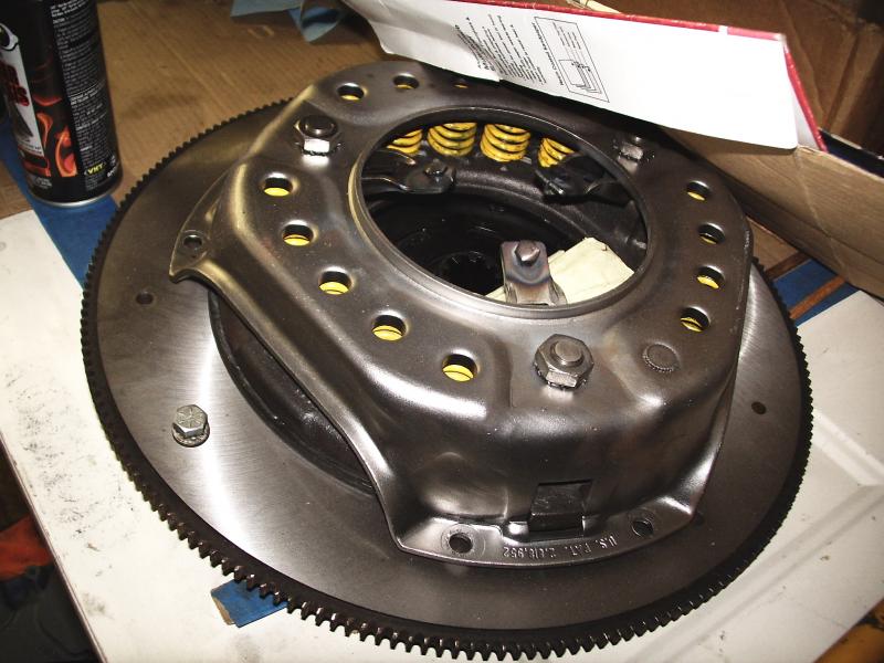

I got my clutch rebuilt here locally here in phoenix brake and clutch for $100 dollars flat, new disks, they even put ass many springs in as they could to beef it up more no extra charge soo if any guys need a clutch let me know these guys did great work! 4 day turn around! My flywheel went with my rear emergency band style brake on the tranny right next door to a truck shop. They machined the flywheel, new pilot bearing, flipped the starter ring, and relined the emergency brake with a new pad for $60 gosh I couldn't thank them enough they were excellent.

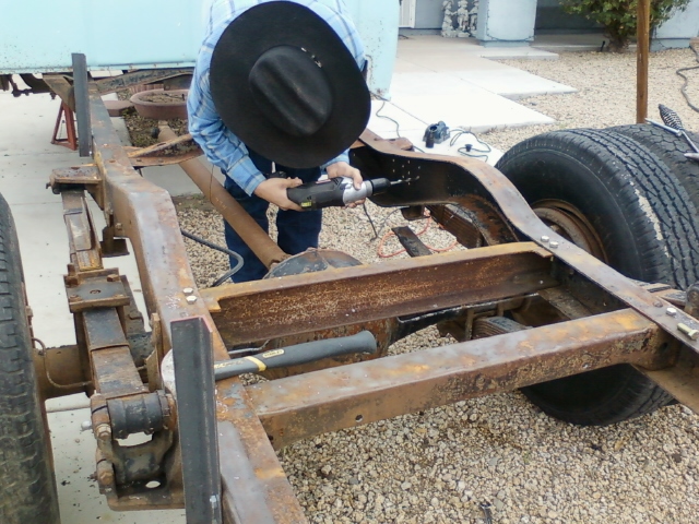

I also while the bed was off got going on wire wheeling the whole rear end axle and all, for a nice coating off por15 and the axle red off coarse! I had a couple of broken rivets soo I drilled them out and replaced with grade 8, made a frame reinforced/goosenck mount out off some 3/8 channel and replaced every body bolt to be found with grade 8

Very nice job! I've never seen cast rockers in an IH before. I used to have a b160 dump truck with a 264 i6 engine. I wonder how the 266 v8 compares? Does it have a 2 speed rear axle?
Its funny you mention the cast rocker arms:) neither had I! But I call my truck being a 59 a prototype v8 for the reasons off the uncommon cast rockers,one piece thermostat housing and intake manifold thats more higher rise with no welch plugs in it! The heads are also different being no restriction or hump in exhaust port and here comes the major part! Now we all know IH top end oiling problems but the way mine is set up seems about the best design iv seen. I was scared after I read the lack of oil people get to the arms and flow and cam bearings. My truck wasn't ran on the right oil for the last soo odd years because the pos had no idea about phosphates and flat tappet cams or what they needed was dino oil for it. But when I pulled it apart there wasn't even any signs off wear and tear on the rocker arms,shafts, valves, cam bearings I mean seriously not a Mark or scratch of pain! I just cant believe it for not running proper oil in, I know I got lucky maybe cuz the low miles?? Now my rocker arms don't just have one oil hole per shaft, each stand besides the outsides have oil holes from the heads up through the stands to the shaft soo all of them get oilled through numerous holes instead of the single one. I have yet to see another like this?? The head holds oil in a galley and shoots up through each hole to the rocker arm shafts go figure. I like this more because in terms it just means easier oil flow and more oil flowing through the top end on down:) and boy does it oil good. So my guess is I have a really early style motor, but the extra oil capacity I bet saved my motor. The only reason I can come up with why IH stopped this design is the rocker arms being so darn heavy to push up and down?? It sure oils better then most I see. Maybe someone else has one out there?? I like the idea and besides cast just means more heavy duty in truck terms:)
You can kinda see in the rocker arm pic how the oil from the shafts run into the rocker arms down to the tips off the push rods and also squirt out onto the tips off the rocker shafts also, the oil shoots out at a angle right on to them and runs down to the pad and valve pretty well.

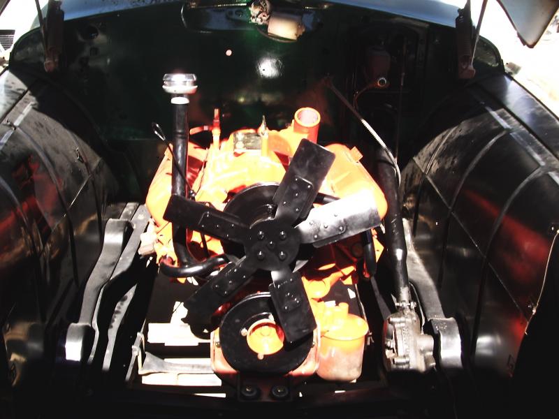

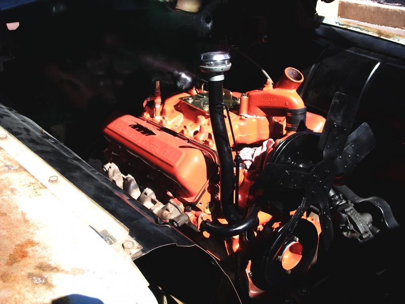

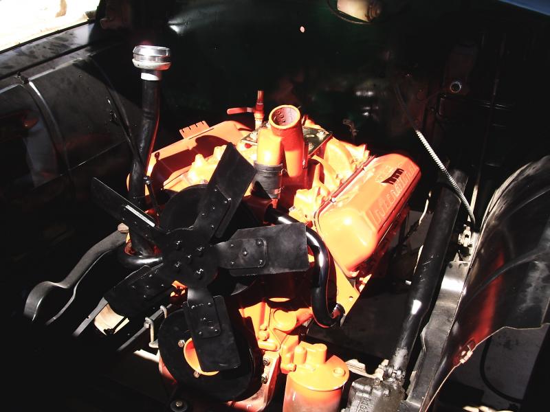

Well some update today, got the motor finish painted, got the intake on and sealed, got the water pump fan and tubes squared away, all freeze plugs in and rocker assembly's finished up!
Soo this past Friday I decided its going in, that's were it kinda went south, I bolted the flywheel up went to install pilot bearing and accidentally nicked the race with the socket soo pulled the flywheel back off drive down to buy another:mad2: got that one this time and must off been frustrated because I flipped the clutch plate around not paying attention and there was no markings on it but I didn't realize it so I bolted up the pressure plate and away I went.:mad2: after getting it hooked up to the tranny and bolted down I assemble the clutch linkage to instantly feel my heart sink that something isn't right it was to dang tuff to push in and felt like it was binding a ton. After seeing the pegs on my linkage not laying flat I am thinking the throw-out bearing position needs to be adjusted, soo Saturday night engine comes back out on the hoist to start fiddling with that. After me and my Dad realize wait the throw-out bearing is keyed and not even adjustable so what is happening here, he shines the light because its dark now between the pressure plate and I see light soo I yell whats up with this?? We unbolt the pressure plate see my mistake, take some measurements to realize that was it and we worked to get the engine back in and bolted down once again by 10p.m. After it was bolted we hooked up the linkage and bam it worked flawlessly smooth as butter:smilewinkgrin: adjusted it and its working fine now:smile5:
soo all in all the engines in snug as a bug once again it looks small in the big hood of my truck lol it was a good learning lesson for me also, iv done 50 clutches but it only takes one to rush and mess up backwards lol

A good and easy to do investment at this point would be to put a thermostatic clutch fan on that water pump. It will save a ton of fuel at the rpm's you'll be running that engine and you'll pick up a bit of hp too.
You red my mind on the fan clutch but hears my dilemma with that. I really want to put one on but when I had the radiator in last the fan was already right up almost against the radiator with just a one inch spacer installed:( so being the clutches are like 3 1/4 inches there's no way il be able to squeeze it on in. Off coarse il double check when I get it all put back in but I am dough full:( I really would prefer to have one that's forsure!!
I am just sure glad I caught my mistake and didn't even try to turn the motor over yet with it like that or I could have been ugly lol
