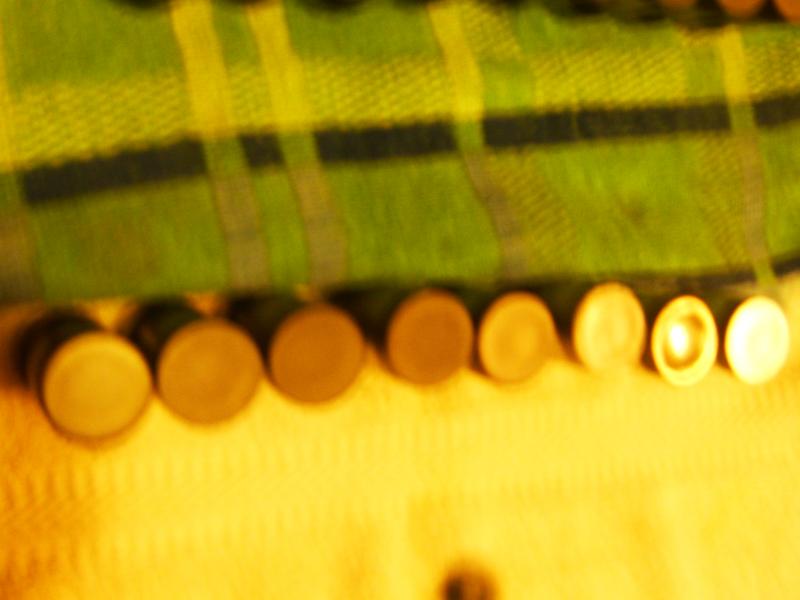

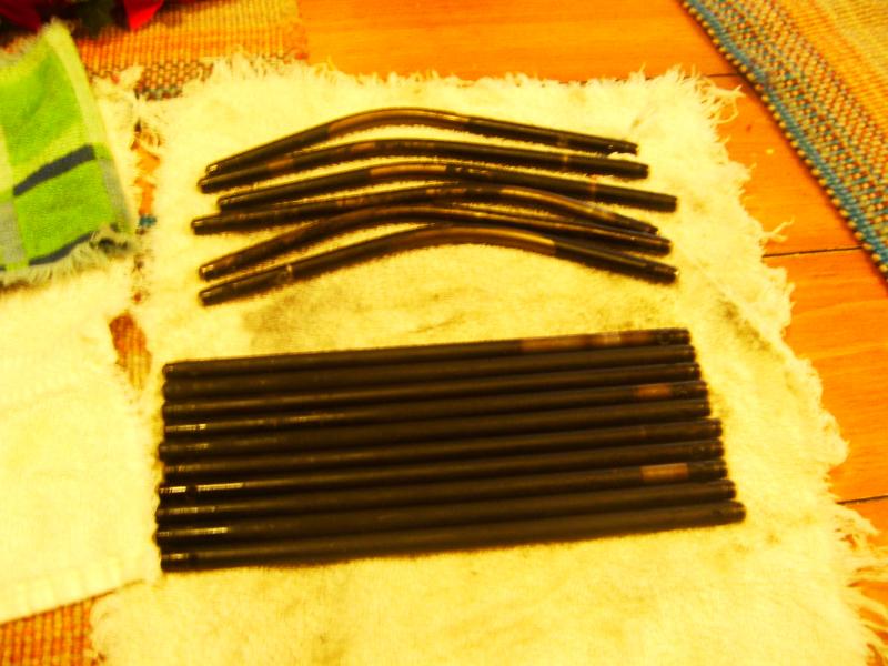

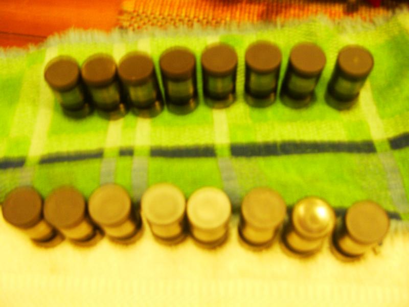

Hello new to the forum, today I pulled the valve cover from the passenger side abecause of a no compression problem and found the lifter and pushrod missing from the #4 intake side of the hole and 2 more bent pushrods in 6 and 8 but the lifters are still there. Not quite sure what happend but we had it running so good and it just went away in a matter of seconds. First question is where the heck did the lifter go and what would cause the rods to bend.never seen anything like this,the vehicle is a 74 p/u with a 392,it did have some gas that was most likely made by the cavemen but 15 gallons of fresh gas and some 2 stroke should of helped,is this thing worth the time to rebuild if it needs it? I got the truck for free but it sat since 2001 its all original and looks good,any thoughts would be appreciated thanks
