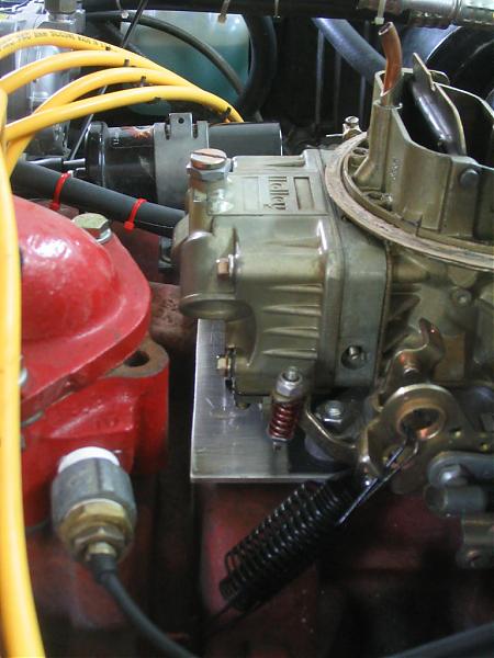

I must apologize to the board for also leaving out some crucial information that would have changed the responses. I don't have the standard IH t-stat riser and I don't run a rs t-stat. My riser is home made and I run a superstat 180*. The port I drilled is below the level of the t-stat, there is nothing for the probe to hit inside, it's just an open hole. There is no need for an extension pipe. You can see the location of the port, between the sp wires, directly in front of the carburetor mounting surface, in the picture I've attached. Since I believed it was not part of the equation, I made the mistake of not telling you about it.

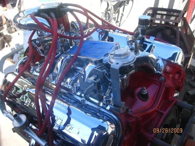

That big hunk of rpt aluminum sittin' on top is sure inspiring. It's undeniably the jewel of this motor. Credit the Ismail's for its creation. All I tried to do was build a display case befitting a true thing of beauty.
