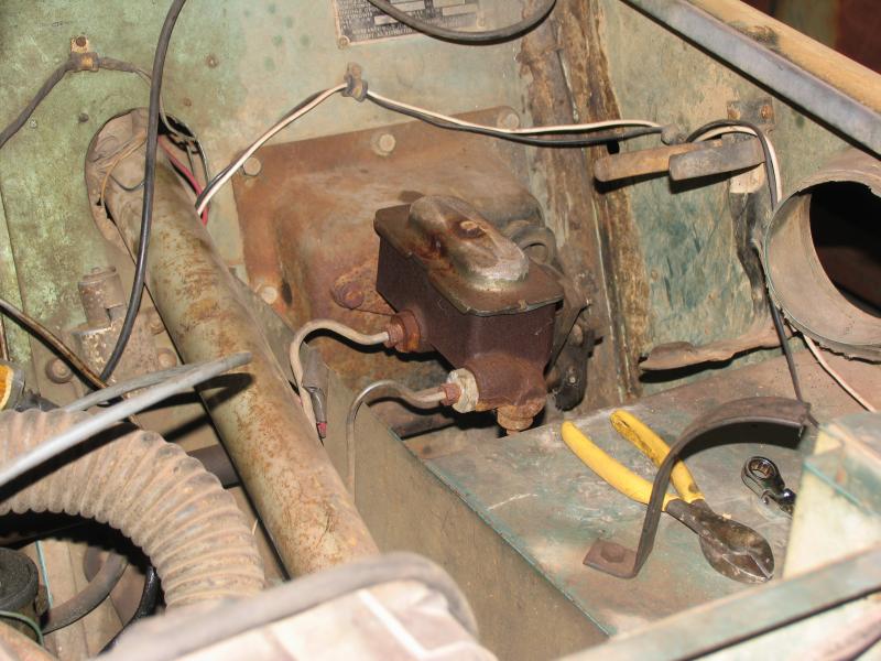

I looking for a complete rebuilt master cylinder for my 800. The one with the ports on the passenger side. Anybody know who might have them without having to modify the push rod?

IH only and IH Parts America both carry the proper part, I believe that Isa does also.
Thanks michael, I called and checked and what they carry is the one with a straight 1 inch bore. I need the 7/8 x 1 step bore master cylinder.

Here's a photo of the master cylinder I'm trying to find.

Good luck finding a new or reman of that particular master cylinder. Possibly iho in Lancaster might have one but you will have to call them. The one we sell is the closest working version that we can find at this time. Otherwise you can send me your current master cylinder and I can have our rebuilder's rebuild it.
