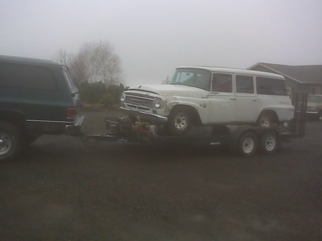

So while attending the 2008 Binder Bee my wife fell in love with the round body t-all. I have been sort of looking around since then for a deal on one. Well we finally found one that she liked. Stay tuned...

If that's the one I saw at the roth's compound, it is one of the most "original" and cancer free ones I've ever seen. Other than slight body work, it could be a real looker and I think it had the bw auto to boot. Very classy!

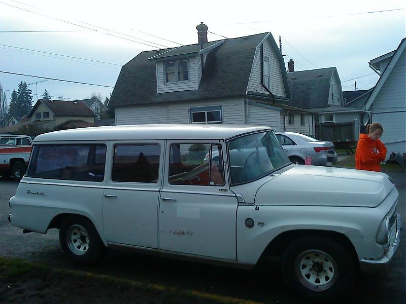

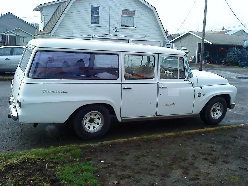

Ken dropped off "buttercup" today. Now that it is home I see it is a 1000 series, I believe that means it has the torsion bar setup.
I got a few pictures of buttercup before it got dark.
Very slammable! The torsion bar schnozz is the best deal going! I have the four "reversed" wheels ya need (with 8" rims), I can swap with ya for the rims ya got on there when the time comes and they'll take "internal hump" moonees. But it's gonna beg for some red stripe tiger paws to complete the look!
And remove two leaves from the rear spring pak to level it out (or use lowering blocks, I have a couplea sets of those also).
None of the above costs squat! And you will end up with a ride superior to the 'burban that no doubt gets much better mileage.

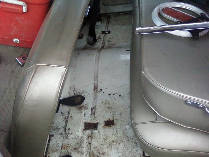

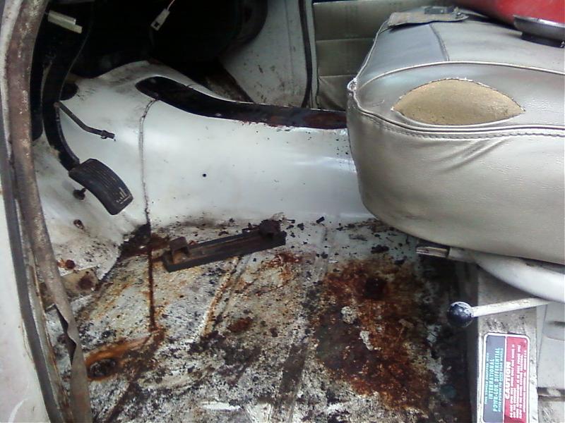

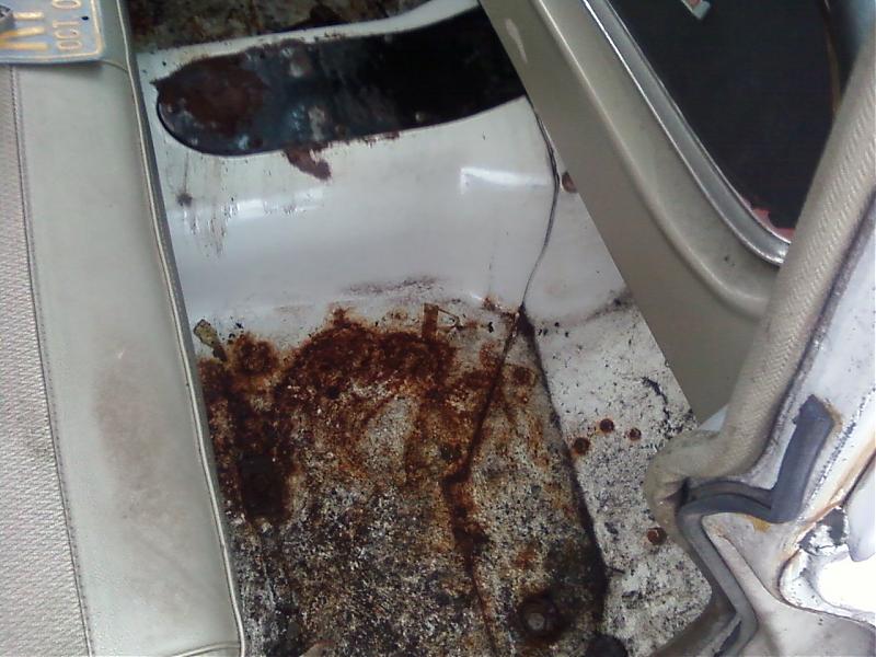

I managed to get the rear glass down so I could open the tailgate. The wooden floor in the back is soft and needs replaced, but I had already planned to replace it with some nice oak tongue and groove anyway.
Maranda pulled the carpet out and the floors look real nice. I can't believe how solid this thing is. :cornut:

Hey monte, you gunna lower it or was mm blowing smoke?? Could be a bitchen looking chop.....say 2-3 inches. Maybe to nice a IH to f'up though.
hey monte, you gunna lower it or was mm blowing smoke?? Could be a bitched looking chop.....say 2-3 inches. May be to nice a IH to f'up though.
Chopped would be really cool, but it isn't going to happen. I do plan on lowering it a little. I imagine the engine swap will actually raise the front. :yikes:
