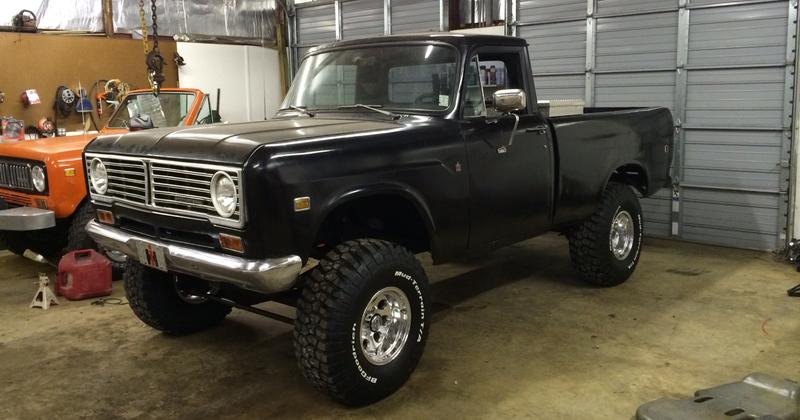

Hey guys, new to the forum here just want to say thanks in advance for the help. I've got a question, or maybe looking for opinions, my current ride is the 1973 1110 4x4 in my sig with t-18 manual transmission. I've got a 1970 1110 parts truck with the bw 11 auto trans. I know the t18 is strong and trouble free but I really like the thought of the auto for around town driving, what's some advantages/ disadvantages to swapping in the auto in place of the manual? Trying to figure out how to upload pics, not having a lot of luck but will keep trying.

Thanks for the reply, I was worried about parts and such for the borg, I will probably stick with the t18 for now until I find a good 727, which is what it originally had anyway. The 266 and t18 was swapped in some years ago.
