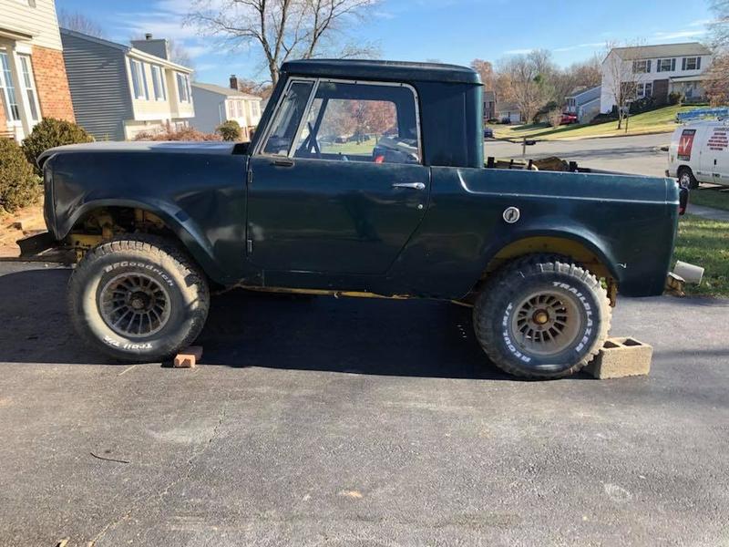

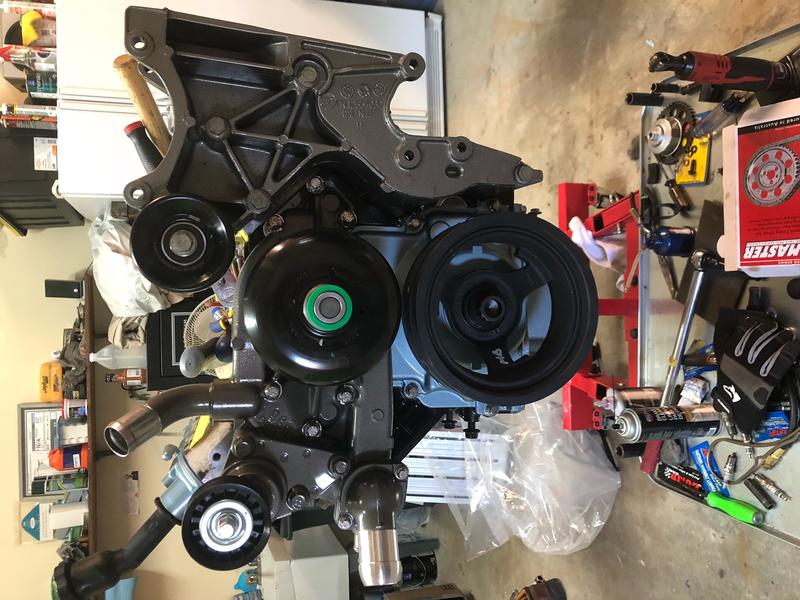

i have a 6.0 ls2 going in a 70 800a. i opened it up, and did a larger cam, rockers, lifters, rods, springs, etc. gonna go with marine 8.1 42# injectors.
i intend to use a early bronco ford 9 rear end (i have a 69 early bronco thats pushing 550 hp at the crank with a stroker, all custom built, so i know more about broncos than scouts!), ill use a scout II dana 44 front, thinking 4.11 gears, with 32/33 range tires, ill do a torque tamer bar to keep the rear leafs from warping under load
gonna do a 4l65 thats beefed up, 3000 stall, with a np241c

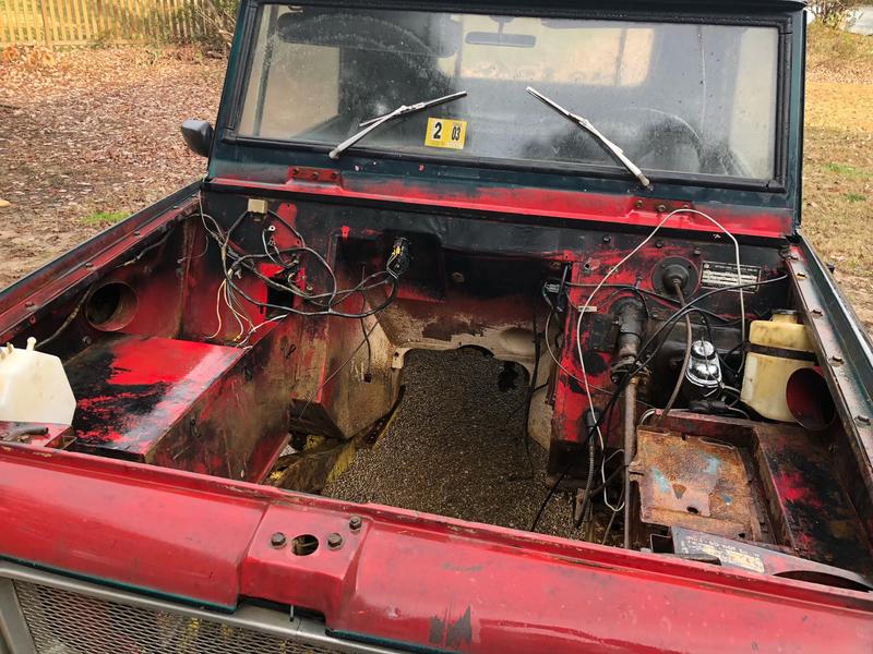

i did order the anything scout motor mounts, i have a centech wiring harness (15 circuit) for the chassis, and was thinking id likely opt to have a standalone harness built, although i did save the factory harness and could have it rebuilt
i intend to run hydroboost, with 4 wheel disc brake, but havent seen a good bracket yet for the firewall to hydroboost unit (do you know of one, or should i build one?)
i was gonna have tom woods custom make my drive shafts
