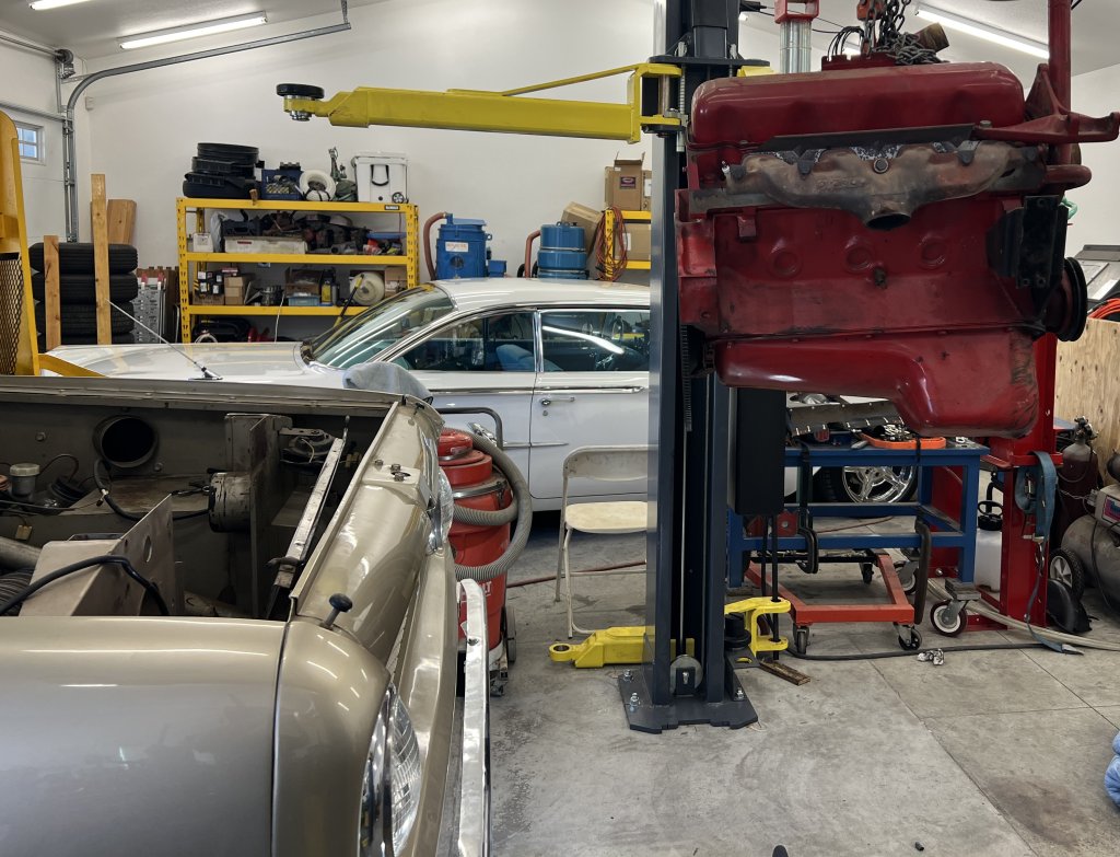

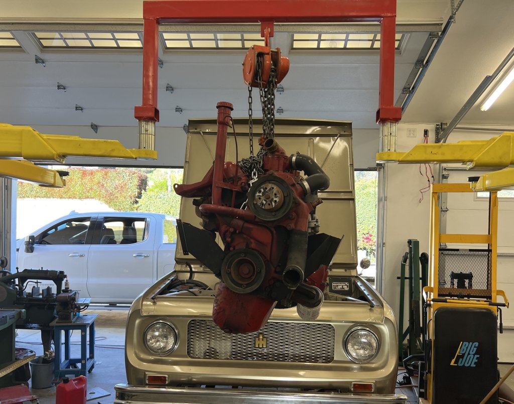

Fast forward to 2024,I'm debating selling the Scout because I just don't use it enough. I don't want to sell or try to sell it with the ticking lifter which has become a bit worse. Regardless of selling or not, I pulled the engine to find the issue.

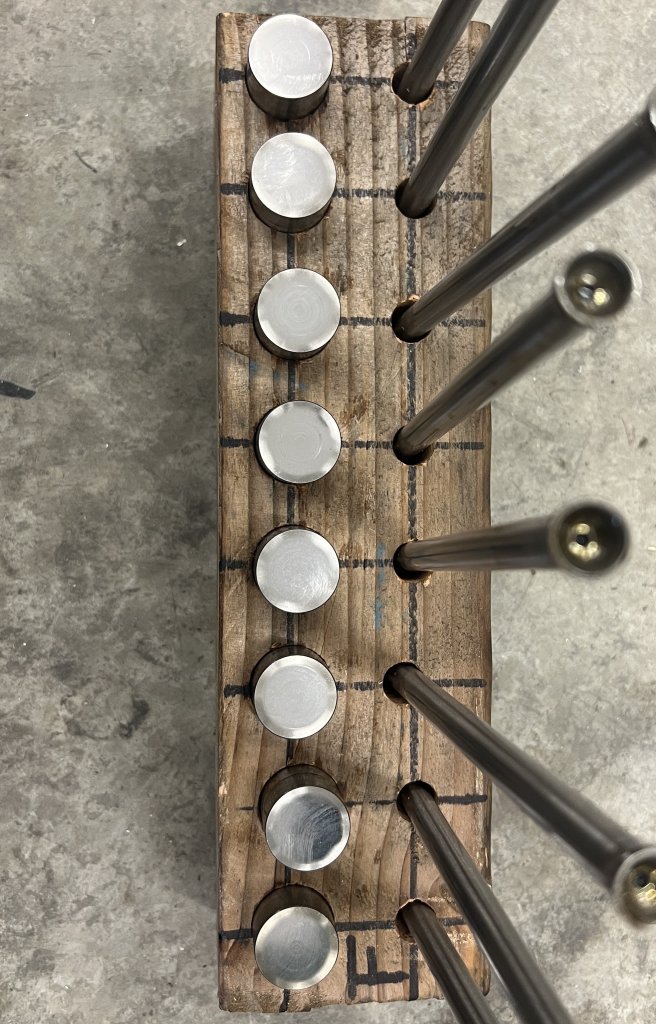

Cam and lifters look great. All lifters rotating as they should.

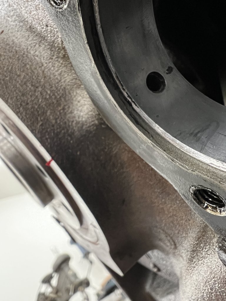

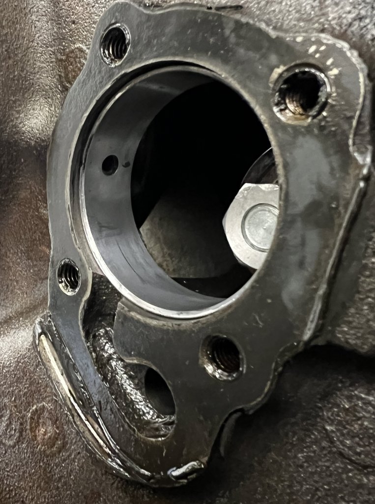

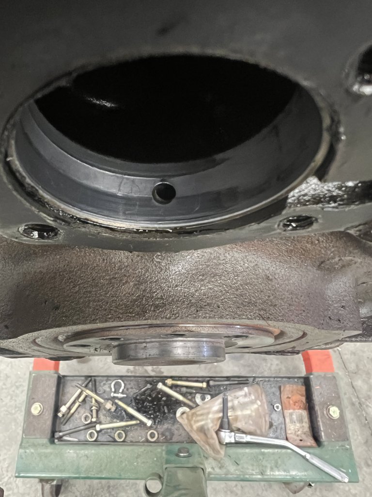

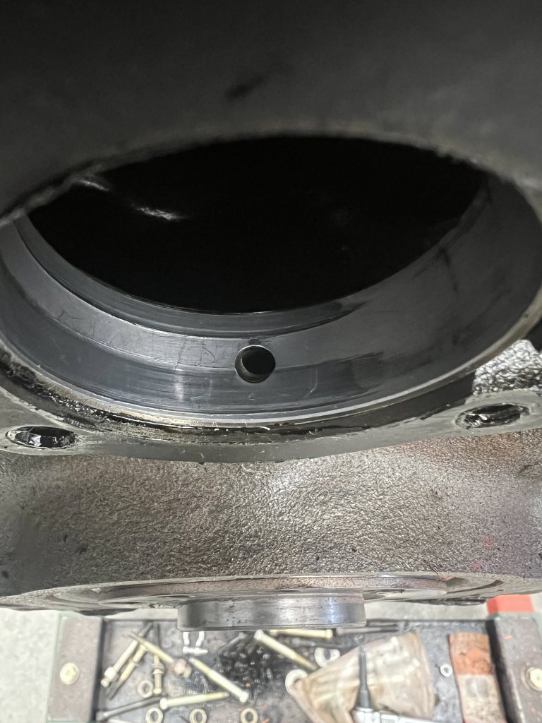

The rear cam bearing placement is likely the cause of lifter ticking at idle. To far to the rear and clocked poorly. Likely a 30%+ reduction in oil supply flow to the lifter gallery supply. The rear ward placement also impacted the bearing area available resulting in bearing subsidence which can be seen in the photos.
The valve / rocker arm supply was largely restricted also due to cam bearing placement.

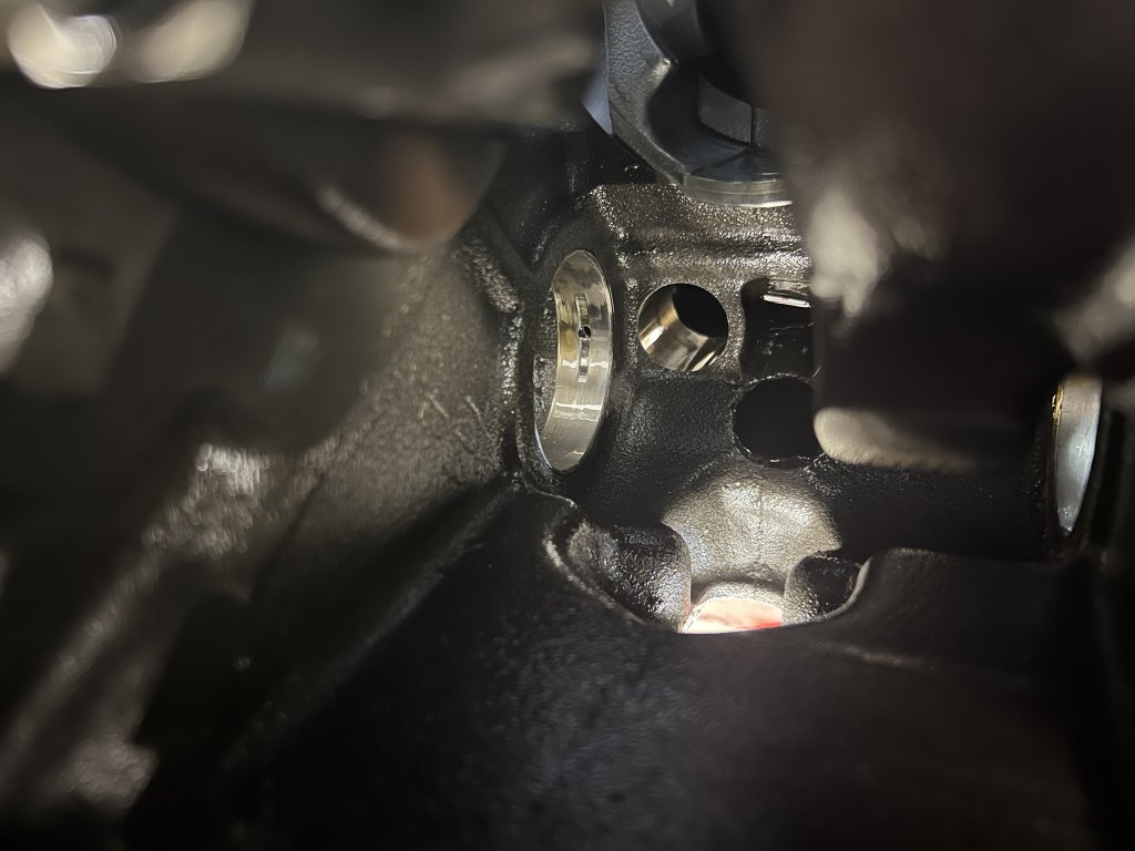

Got the old bearings out and placed the new rear bearing. Lines up well and set flush with the front edge of the block bearing bore.
Should be able to get the last 4 in place tomorrow evening. For sure with the crank in place things are difficult to see.
All bearings installed well, front cover, crank hub, and pan installed. Later today, valve train, and valve cover go in and on to complete the revisit.

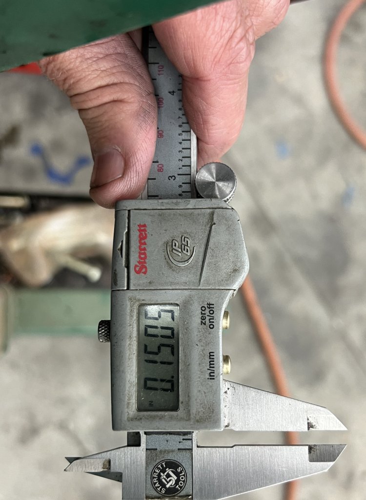

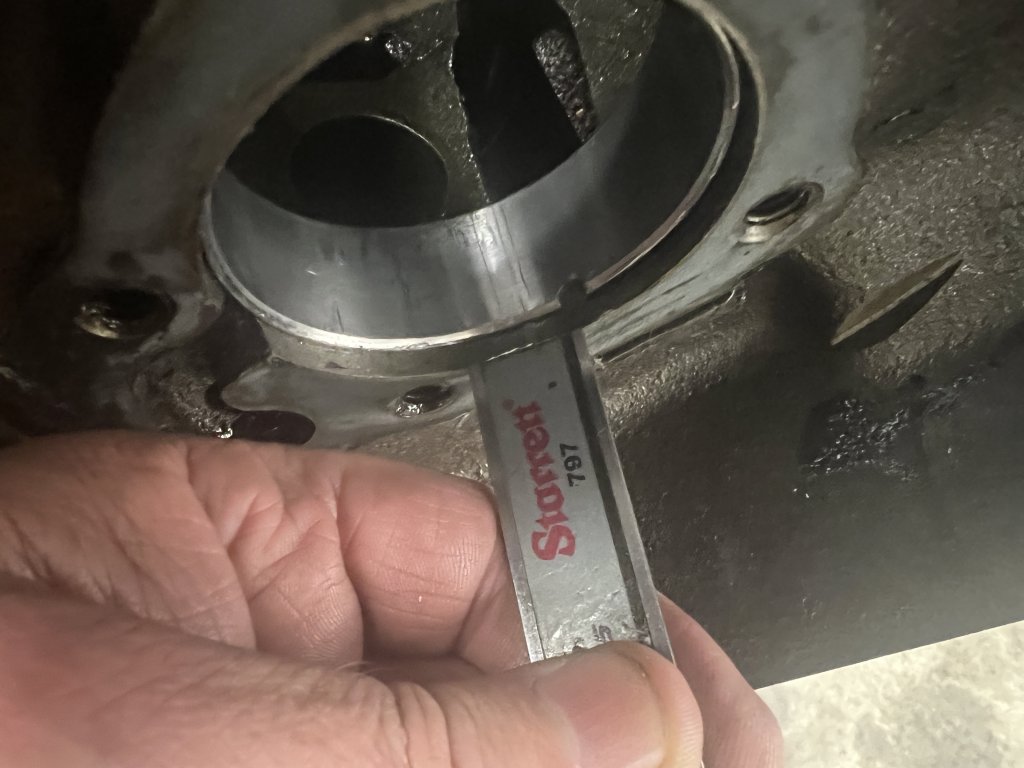

These are very sensitive to the rear cam bearing position. I attached a few photos of the measurement to take care of getting right no matter who is building up your SV or 1/2 SV. Both clocking and depth locations are critical.
