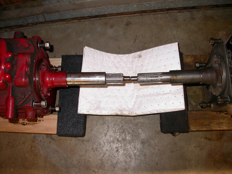

Looking for a long front bearing retainer/nose cone for a Scout T19. These are used with the AMC straight sixes. Want to get the machined section that the throwout bearing slides on turned back about 1/4" so I can run the longer throwout bearing sleeve.Need one like the one on the red close T19 on the left. They are quite a bit longer. Willing to buy or trade for a standard bearing retainer like the one on the wide T19 on the right that fits everything else. Those ridiculous looking furniture dollies they sell at Harbor Freight for about 12 bucks are ideal for rolling T19s around on.

i have 1 on a V8 close T-19 & the end of the housing is about 1/2 " from the starting of the splines. ( rear part of splines ) so that is the difference between the 6 & V8 tranny's. the 6 cyl., 1's are longer.

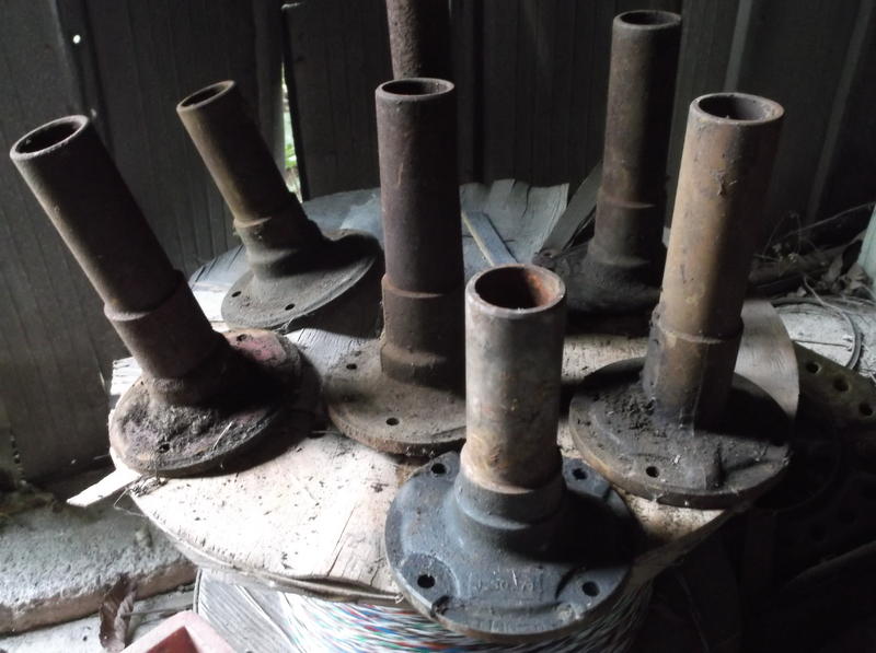

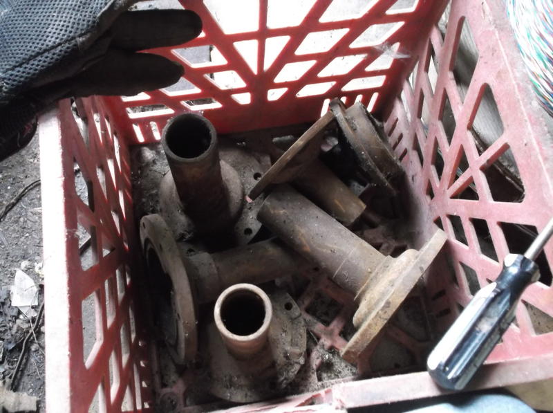

2nd pic,the front 1 on the spool is from a T-98, not sure what the rest of them are, mostly IH. the T-98 ( short 1 ) is 5-3/4" total length. the 1 to the right is a total length is 7-5/16". same size snout or bearing collar, base & the oil hole appears to be in the same place.
