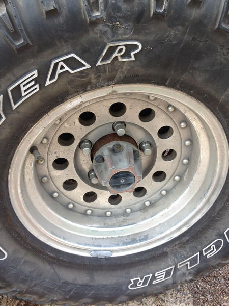

Can anyone tell me if this is a Scout locking hub, or some other animal? There are no logos or markings other than the 2 and 4. Google images wasnt much help and before I tear the noisy one down id like to know where to get parts or if I should replace with something else.

Those particular locking hubs came stock in 1980 or could be purchased in the aftermarket. They are weaker than the warn premium hubs that most other Scout's came with and not worth fixing. Here is a link to the warn premiums on our store - warn premium hub - IH Parts America
