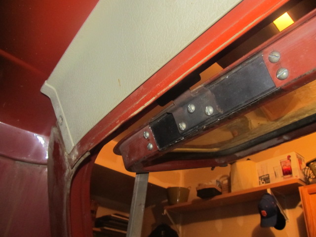

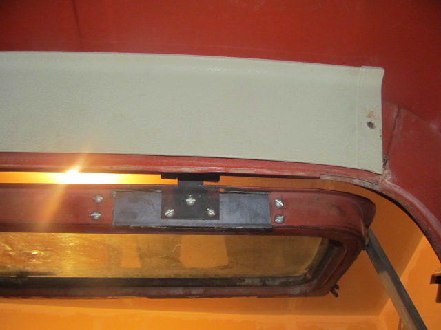

My lift gate was rusted out where the hinges attach. I used a dremel tool and cut the cancer out and patched the opening with 1 1/2" x 1/8" flat stock. I then drilled and tapped new holes and rehung the gate. A few welds and some paint and she'll be like new, or better ;)
