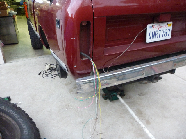

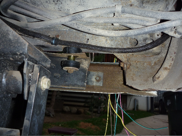

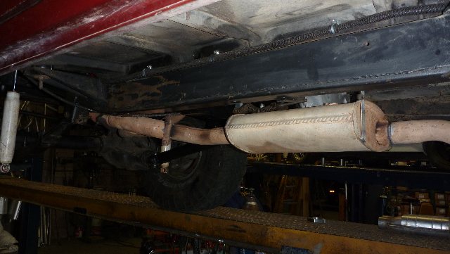

I ended up just running them along the frame and loomed them. I didnt feel like sticking those things through that nasty frame with tons of eugene clay in it.
I did mine along the frame too (the floor pan pinch weld actually). Seemed to be a shorter route. I made all of my left and right side light connections in the left tail light bucket. Easier to work standing up. Then continued the loom to the right side.
