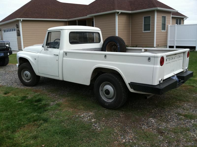

Here is a 1968 pickup that I have been working over for the past couple years. I am posting pictures here so they can be viewed over the net.

This truck was a one owner very low miles, the bed is hardly used not banged up or dented at all.

One of the cool things to me is the fuel filler is not in the fender, takes fuel at full fill pressure. Still has the factory step bumper also.

So when I bought this truck it was a 2wd, I converted it to 3/4 4wd. I rebuilt a set of 73 axles from my travelette, because it had gotten Chevy tons. I also had a new exhaust installed after the switch. It is very easy to convert one of these. I used a 205 t-case from a 70s harvester, rebuilt a spud shaft, and had the rear drive shaft made and balanced, also had to grab a front shaft, had it balanced also. Here in montana 4wd is used a lot so I have found it very nessary to balance and new joints because of the highway speeds any viberation is really felt. This one is good to 60mph thats about all the truck wants with the 4:11 gears.

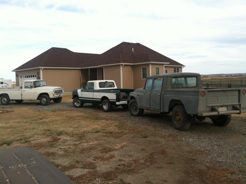

Here is a picture of the travelette, as I said I have tooooooooo many harvesters. If you have not looked check out the 34hotrod I am building that for this summer and maybe selling the 68 to fund the hotrod:mad2:

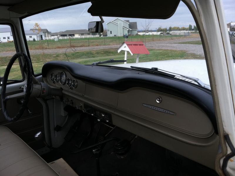

Check out this dash the truck has 78,000 miles and the gages look like they were in a time capsule.

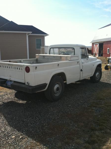

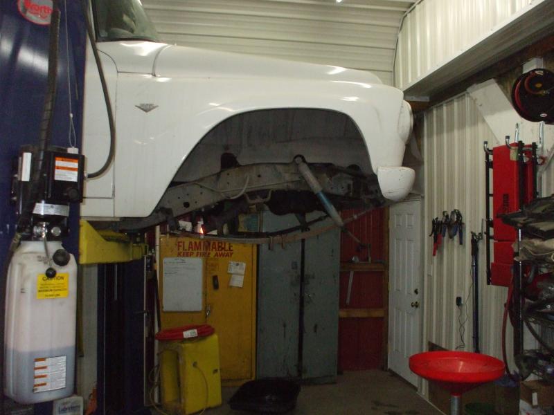

As I said earlier this was a 2wd truck when I got it, I think that is why it was in such good condition. Well a few days in the shop and we now have a 3/4 ton 4x4.

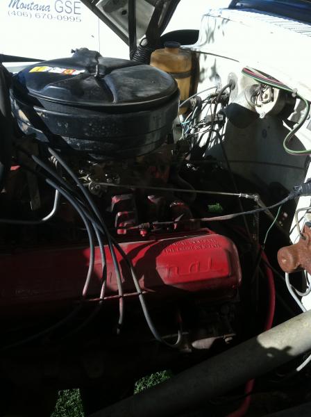

This is a shot of the engine when I got the truck. Still has the oil bath air cleaner, very untouched.

Nice!
It May have a title from 1968 but the front fenders are from pre-1968--no side indicator lights.
I like the fact it doesn't sit so high.
What springs did you use?
My '65 d1200 t-all is too high for my wife and daughter to get in easily.
Since it rides like a lumber wagon I was thinking of re-springing it with some springs that aren't quite so stiff.
nice!
I was aware of the marker lights also lack of trim, my thoughts were very early 68 or as you said carry over from 67.
Springs are the ones that were on it when it was built so there again 67/68 2wd 1/2ton with over loads in the rear.
