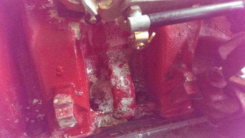

Alright this is going to be a bit long winded but need to get the background out there. I've got a '74 Scout II with 345 and 727 trans. Also, I've installed a Holley carb (0-7448). When I bought the truck, it did not run. The po had stripped the spark plug threads on the #1 cylinder so I took the head off and had a local cylinder head machine shop install an insert into the head to accept a spark plug, so I never heard the truck run prior to installing the Holley carb. Ever since I've had the truck running, I've had a 'run-on' problem when trying to shut the truck off, sometimes last 20-30 seconds and always ending with a loud 'woosh' and white smoke gushing up through the carb. I don't drive the truck for fear that I'm running lean and thats whats causing the run on. I've been trying to diagnose the run on but I'm at whit's end. I have had trouble getting the idle speed down into the acceptable 700 rpm range. If I adjust the idle mixture screws or twist the distributor to drop the idle speed, my manifold vacuum drops substantially and the engine stumbles (I have a vacuum gauge hooked up to manifold vacuum and have the vacuum advance on the distributor disconnected and plugged). I'm at sea level and have found that the motor seems to run better right at 0* btdc. The idle mixture screws are about 1/2 turn out and that gets me to 850-900 rpm with the truck in neutral and I'm getting good manifold pressure (~18 mmhg) another issue, the motor is running hot, coolant temp climbs to 230* just under idle after 15-20 minutes of running! I wondered if I have a vacuum leak so I started spraying around the intake manifold and noticed that right in the middle of the intake manifold, I get lots of bubbles. It occurs on both sides (picture included). I wondered if I have a vacuum leak or if that portion of the intake manifold just runs hot which is boiling the fluid when I spray. This bubbling does not occur at any other location on the manifold. I've tried using seaform to clear out carbon deposits. I did get some carbon out of the exhaust when using the seafoam but otherwise, no noticeable improvement. I also decided to try colder spark plugs, I had champion plugs in (12 heat rating) and swapped them for autolite 303. I know the individual manufacturers' heat ratings don't correlate 1-to-1 but figured it was worth a shot. When inspecting the champion plugs, the ceramic looked pretty spectacular. They were all tan in color.

1) are the bubbles I'm seeing evidence of a vacuum leak? Causing my higher idle rpm?

Also what are you spraying on the manifold? It's bubbling in that area because that is where the exhaust cross-over is for heating the carb.

Roger that, thanks fdchappie, that explains the bubbles I'm seeing. I do not have an egr installed, I removed it and installed an egr plate. I live in sc so no smog tests, heck, we don't even have annual vehicle inspections! It May be the perfect state for owning a Scout, haha.
