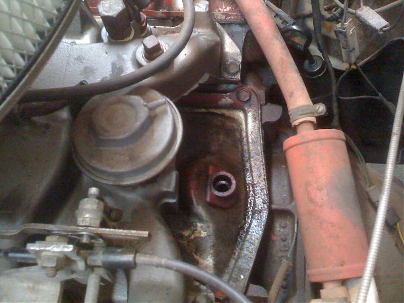

First question: is this hole in the center of the first picture where the pcv valve goes? Isn’t there supposed to be a rubber grommet in there for the pcv valve to fit into.

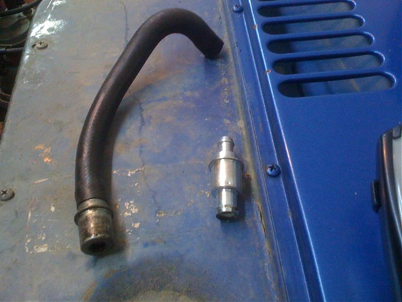

The second picture has what was in it next to what I bought. I didn’t pull the old crusty hose of what was in it because I was afraid I wouldn’t get it back on until I get the right equipment.

Welcome back to IH's!
The pcv valve you have should pop right into the grommet on the valley pan. If it won't then chances are the existing grommet is old and hard. We have new ones available on our online store. But you do seem to have the correct parts there.
But the metal piece in the end of that hose does look the same as the piece I got. I think I May need to get the rubber grommet. It looks like someone put something else in there that sort of fit. It is not even snug it just lifts right off. No rubber at all. Thanks for the info.
And...the "new" pcv in your pic has a nipple on both ends. That is because the same calibration pcv was/is used on many engine apps, not just IH stuff.
The "lower" nipple will stick down into the grommet just fine and not bottom out. If ya just don't want the nipple on there, then cut it off with a hacksaw.
