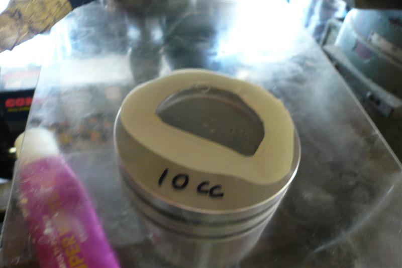

piston d shaped notch volume = 10 cc Corrected to measurement

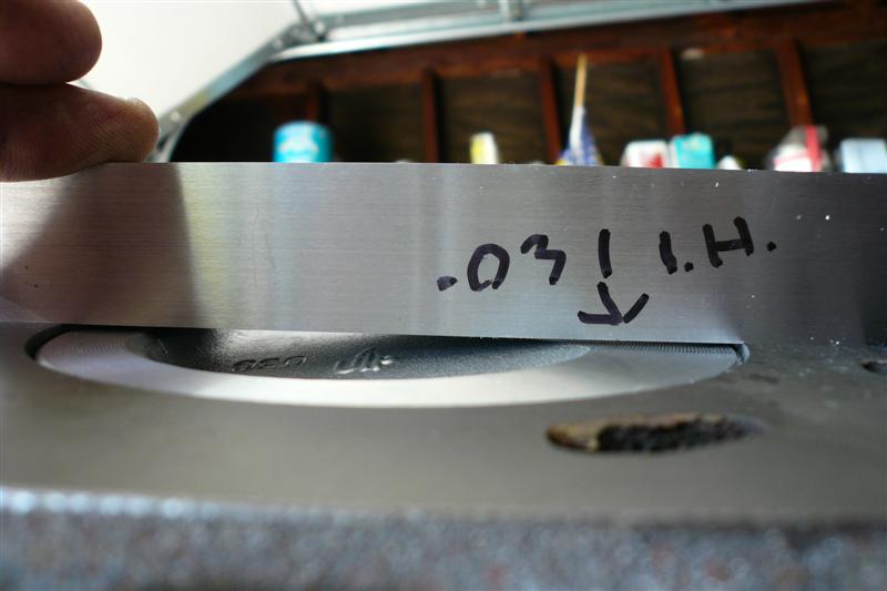

A quick note on the above setup.
Before machining the deck the engine will be mocked to verify for sure that the piston is .033 in the hole.
Silvolite pistons with a compression height of = 1.907
stock unmolested connecting rods ctoc distance = 6.753
cylinder block deck height = 10.521
crank stroke = 3.65625
Finished mocking and rechecking piston notch volume.
I first measureed it at 12 cc, but today I checked it the correct way and find it to be 10 cc. I updated the data in the first post and recalculated the compression ratios.
