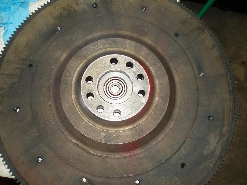

Here's a shot of the sv flywheel drilled for either an 11" or a 12" clutch, this one was swapped to shane for his sii manual tranny conversion. Notice the "counterweight" segment on the engine side, along with the additional drillings which were done on the engine assembly line as the oem engine package was "balanced" during the production process.

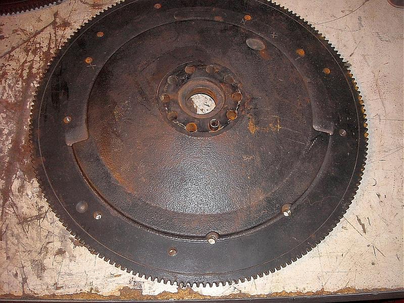

And here is a shot of the 152/196 flywheel that shane swapped me for the sv version. He had inadvertently installed this one (after having it surfaced) and the motor shook lika bitch!
But it's exactly what I needed for our s80 project to go with the new-to-us four speed tranny!
Notice the absence of the counterweight segment on the engine side as compared to the sv flywheel. This one is drilled for either a 10" or 11" clutch, I have two others that are drilled for 10" clutch only. This particular flywheel came from a known 196 inna Scout II.
