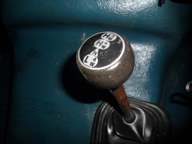

I'll get pics today. It's remote mounted behind a bg241 with a swapped in 4 speed. It feels like it shifts from 2wd to 4x4 then neutral with no low range. Thinking maybe dana200?
If the transfer case is oem, it should be a new process 202 single stick. The ihc model is tc-141 and the code number is 13141.
Direct range is 1.00:1, low range is 1.925:1.
Shift pattern for the np-202 is as follows, from front to back:
2h
4h
n
4l
Looks like I'm missing the last shift point on mine. It only goes as far as neutral. Probably a bent shift fork or something. Wonder if that's the sudden howling noise in the drivetrain after towing a Ford to scrap?
