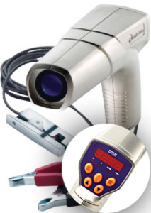

Next would be total timing. That is basically when running in park at a rpm high enough to allow the mechanical or centrifugal to fully come in (lets say @ 3000 rpm) how much advance is set in. I would like to see 34-36 degrees max for now. You will need a timing light with the timing knob or setting. This is done with the vacuum advance disconnected. Again we can walk you through it if you would like.
If you have a digital camera some clear pictures will help greatly. Try to get the vacuum hose routing from all 4 sides of the engine.
This is a good start and will ultimately pay off when your IH is playing nice.
Robert
For total timing, what is "timing setting or knob" reference to? Is that supposed to be a readout on the timing light itself? The only kind of timing light I have is the regular inductive timing light, no readout. Can you explain further? Thanks for the help, some times I'm ignorant, I have moments...
for total timing, what is "timing setting or knob" reference to? Is that supposed to be a readout on the timing light itself? The only kind of timing light I have is the regular inductive timing light, no readout. Can you explain further? Thanks for the help, some times I'm ignorant, I have moments...
Basically the timing setting or knob is an adjust ability built in to an inductive timing light similar to the one you already know and use. Some are a knob and some are a digital read out that usually includes the ability to indicate rpm. This allows you to delay the strobe flash the dialed in number of degrees so the "0" timing Mark on the cover can be used in conjunction with the Mark on the front crank balancer.
Let's say the adjustment on the timing light is set to 36 degrees and while applying the timing light and after increasing engine until the timing marks stop moving(advancing) the "0" Mark and the balancer Mark line up. This means you have 36 degrees of total timing. That would be spot on and no ping or knock should be heard if all other conditions are ok. Remember to do this timing routine with the vacuum advance line disconnected and plugged.
Robert
