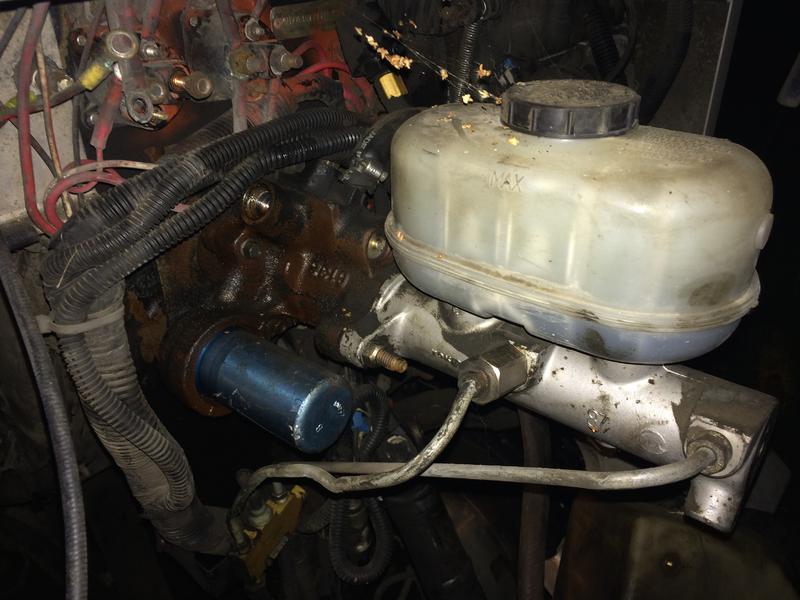

I'm in the final stages of converting my Scout to a 4bt and was going to go with a hyrdoboost setup. I have a unit out of a breadvan. I was trying to see if my master cylinder will work or do I need a different one? It is off a freightliner mt35 (wonderbread truck)
has anyone done this?

I'd be inclined to run the stock Scout mc from a power brake system if that's what you have. The bread truck probably had drum front brakes.
I'll give it a go. The breadvan had 4 wheel discs. It was a 2000 model. Probably tear into it Wednesday night.
My Scout is stock front disc rear drum. I will see how they will marry tomorrow and post what I find.
