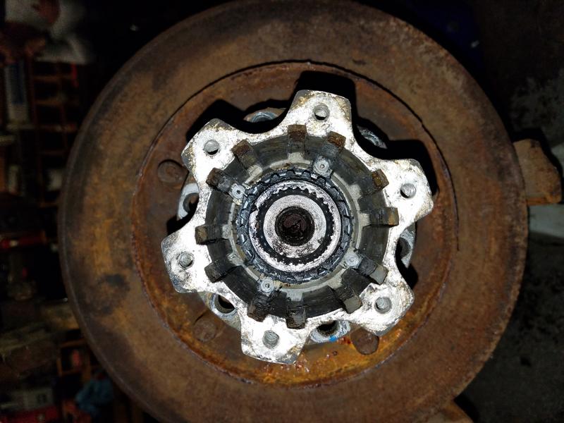

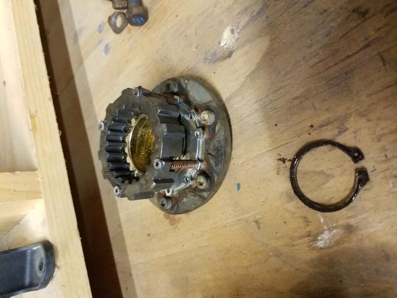

Alright I know this is a stupid question but.. I'm at a loss can someone please ID this hub and tell me how to get the retaining nut off? Its got nobs all over it and I have not seen this before.:confused5:

Looks like your standard Warn locking hub. I see that the snap ring is already off along with the six bolts. You probably have a burr on the axle end. Use a prybar to gently persuade the locking hub off. From there you will find the wheel bearing hub nuts.
