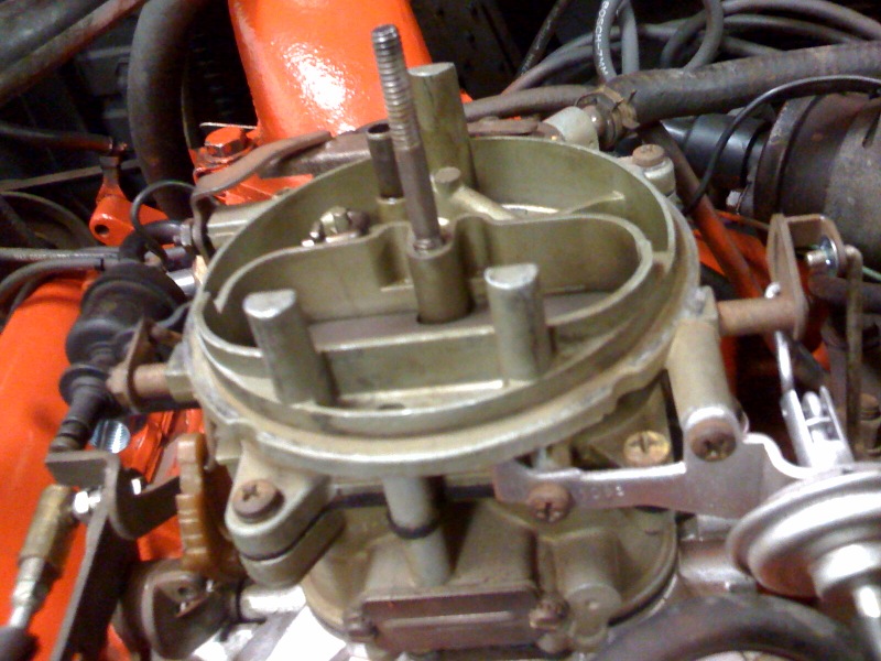

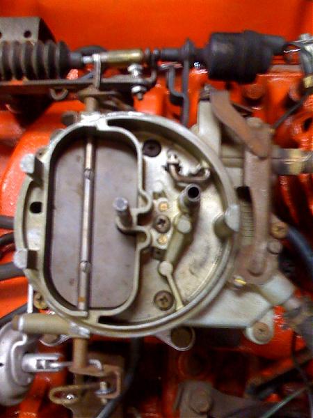

We need to know which "slot" the link rod is in on the accel pump actuator lever. And the link rod must be adjusted (bent) so that there is an immediate pump shot with the slightest movement of the throttle lever. Imperative.

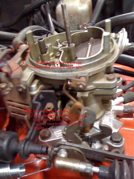

Now I'm in the bottom slot and when I put the crab back together I did have to bend the arm that goes to the a tab on the top of the carb that open and closes. Sorry I don't know what that part is called. Is that where is should be?

I marked up one of your carb photos with the linkage move to give you a bigger pump shot. The same applies to teh linkage slop after the move, there should be none.
